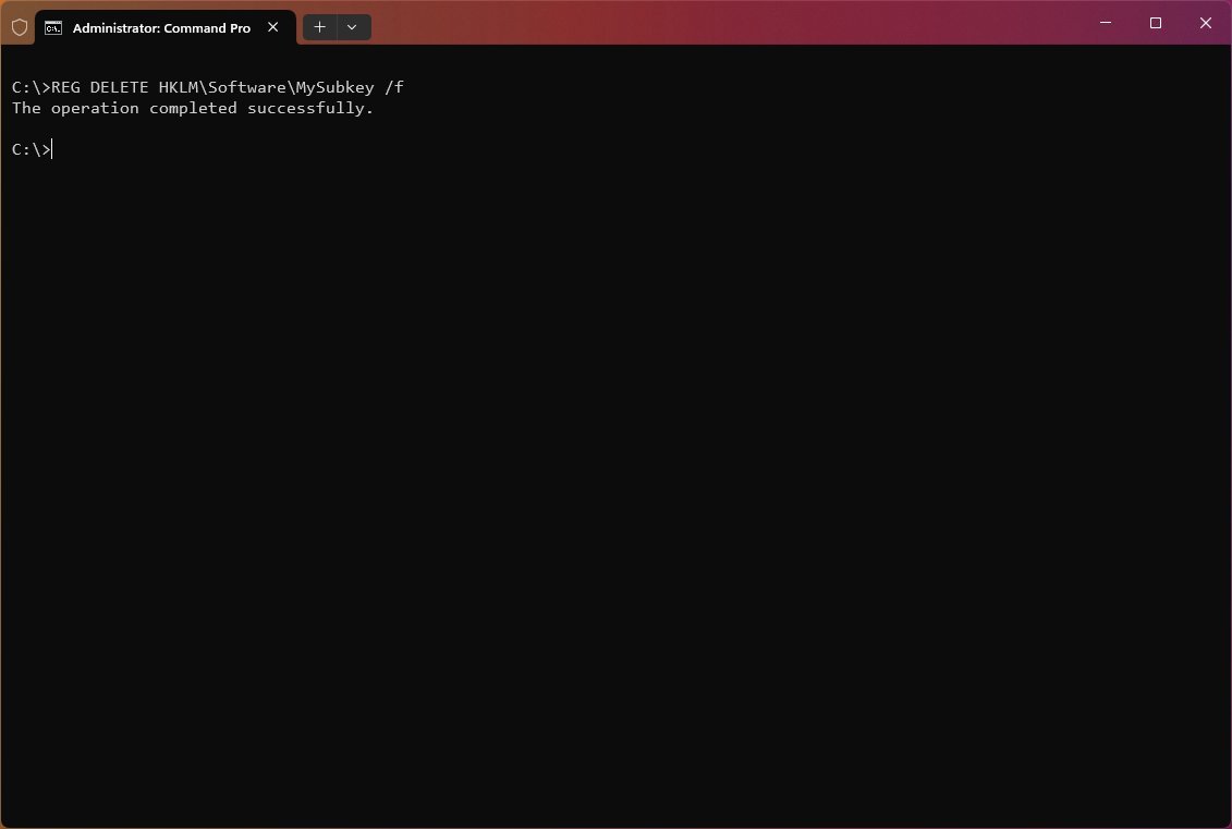

REG DELETE examples
To delete the subkey named "MySubkey," use the following example: REG DELETE HKLM\Software\MySubkey /f
To delete the subkey named "MySubkey" on a remote computer, use the following example: REG DELETE \\ComputerName\HKLM\Software\MySubkey /f
To delete the registry entry named "AppInfo" within the "MySubkey" subkey, use the following example: REG DELETE HKLM\Software\MySubkey /v AppInfo /f
To delete only the registry entries that have no value inside the subkey named MySubkey, use the following example: REG DELETE HKLM\Software\MySubkey /ve
To delete all the registry entries from the "MySubkey" subkey, use the following example: REG DELETE HKLM\Software\MySubkey /va

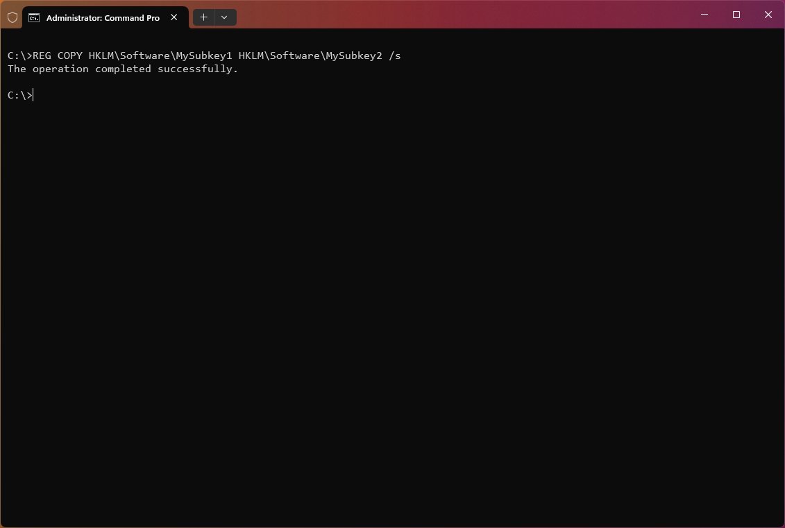

How to copy registry entries
Syntax
- Copy: REG COPY KeyName1 KeyName2 [/s] [/f]
Command description
- KeyName1: Defines the path to the subkey you want to copy. Valid registry key shortcuts include HKLM, HKCU, HKCR, HKU, and HKCC. If you're trying to copy the registry on a remote computer, you can only use HKLM and HKU shortcuts.
- KeyName2: Defines the path to the subkey destination. Valid registry key shortcuts include HKLM, HKCU, HKCR, HKU, and HKCC. If you're trying to copy the registry on a remote computer, you can only use HKLM and HKU shortcuts.
- /s: Copies all subkeys and entries of a particular subkey.
- /f: Executes the copy command without prompting for confirmation.
REG COPY examples
To copy all subkeys and values under the key "MySubkey1" to the key "MySubkey2," use the following example: REG COPY HKLM\Software\MySubkey1 HKLM\Software\MySubkey2 /s
To copy all values under the subkey "MySubkey1" from a remote computer to the subkey "MySubkey2" on the new computer, use the following example: REG COPY \\ComputerName\HKLM\Software\MySubkey1 HKLM\Software\MySubkey2
