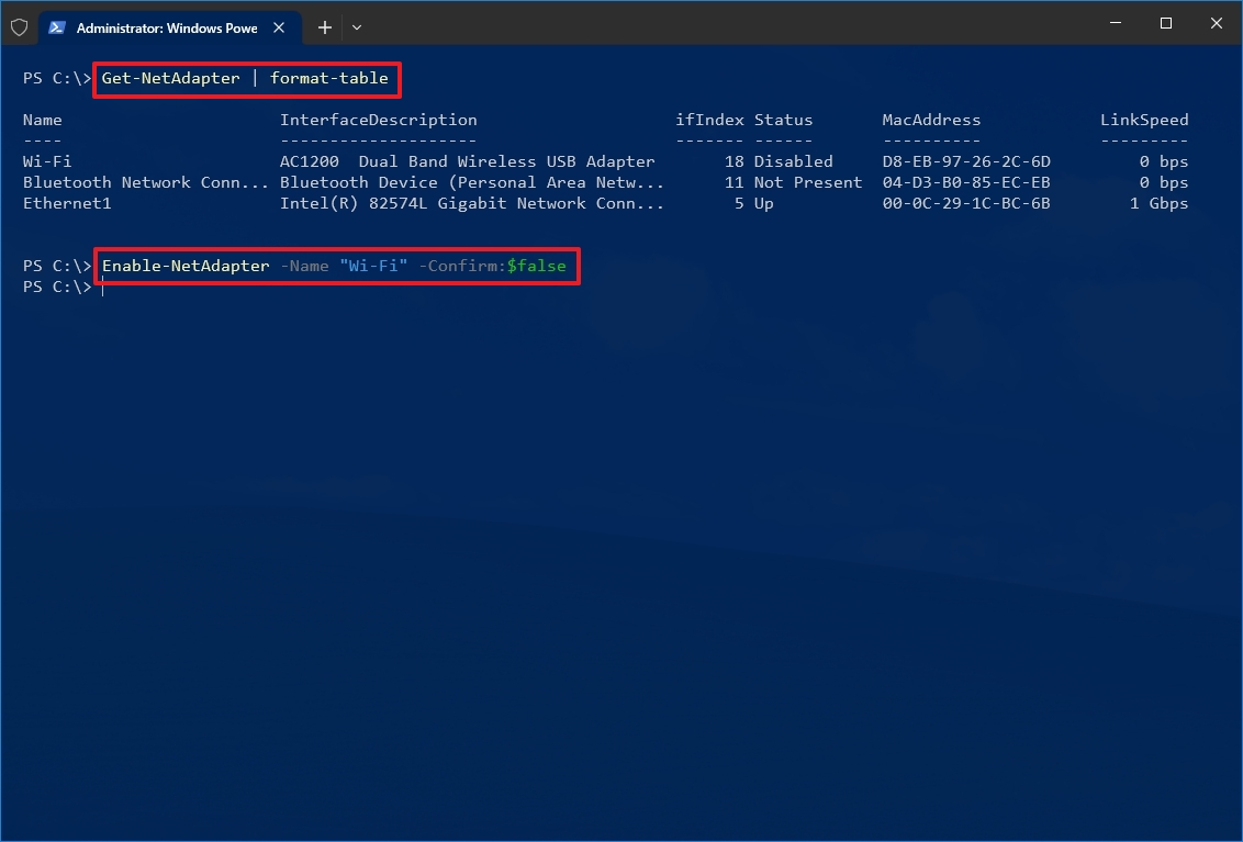

How to enable or disable network adapters using PowerShell
Alternatively, you can use PowerShell commands to disable or enable any network adapters you don't use on your computer.
Disable adapter
To disable a Wi-Fi or Ethernet network adapter on Windows 10 using PowerShell, use these steps:
  1. Open Start.
  2. Search for PowerShell, right-click the top result, and select the Run as administrator option.
  3. Type the following command to identify the name of the adapter you want to disable and press Enter: Get-NetAdapter | format-table
  4. Type the following command to disable the Wi-Fi or Ethernet adapter and press Enter: Disable-NetAdapter -Name "YOUR-ADAPTER-NAME" -Confirm:$false
(Image credit: Future)
In the command, specify the name of the adapter you want to disable. The quotation marks are only required if there are spaces within the name.
Enable adapter
To enable a network adapter on Windows 10 from PowerShell, use these steps:
  1. Open Start.
  3. Type the following command to identify the name of the adapter you want to enable and press Enter: Get-NetAdapter | format-table
  4. Type the following command to disable the Wi-Fi or Ethernet adapter and press Enter: Enable-NetAdapter -Name "YOUR-ADAPTER-NAME" -Confirm:$false
In the command, specify the name of the adapter you want to enable. The quotation marks are only required if there are spaces within the name.
