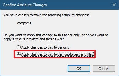

- Under the "Compress or Encrypt attributes" section, check the Compress contents to save disk space option.
- Click the OK button.
- Click the Apply button.
- In the "Confirm Attribute Changes" dialog, select the Apply changes to this folder, subfolders, and files option.
Once you complete the steps, NTFS file compression will enable in the folder reducing the size of existing and future files you save into this location.
