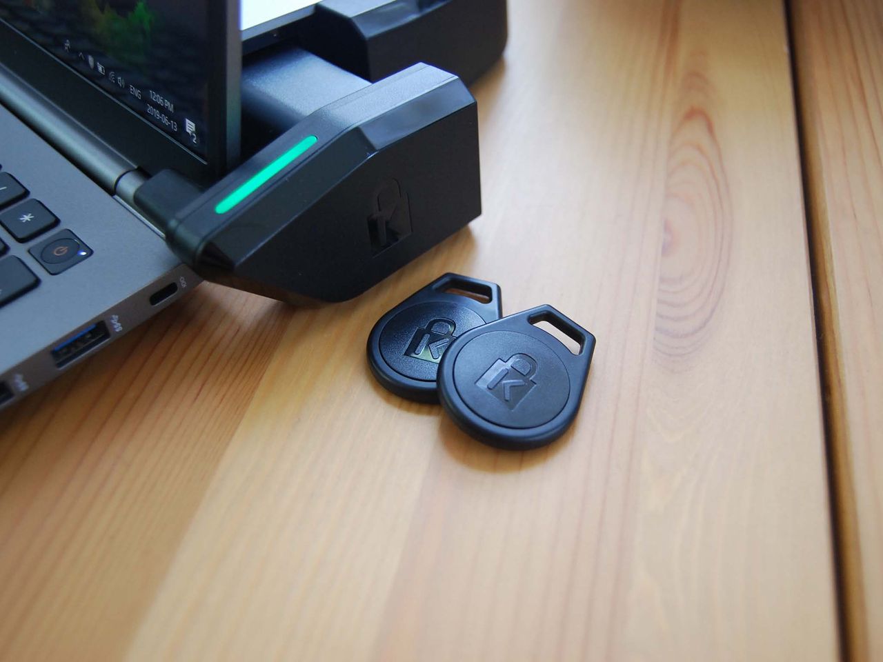

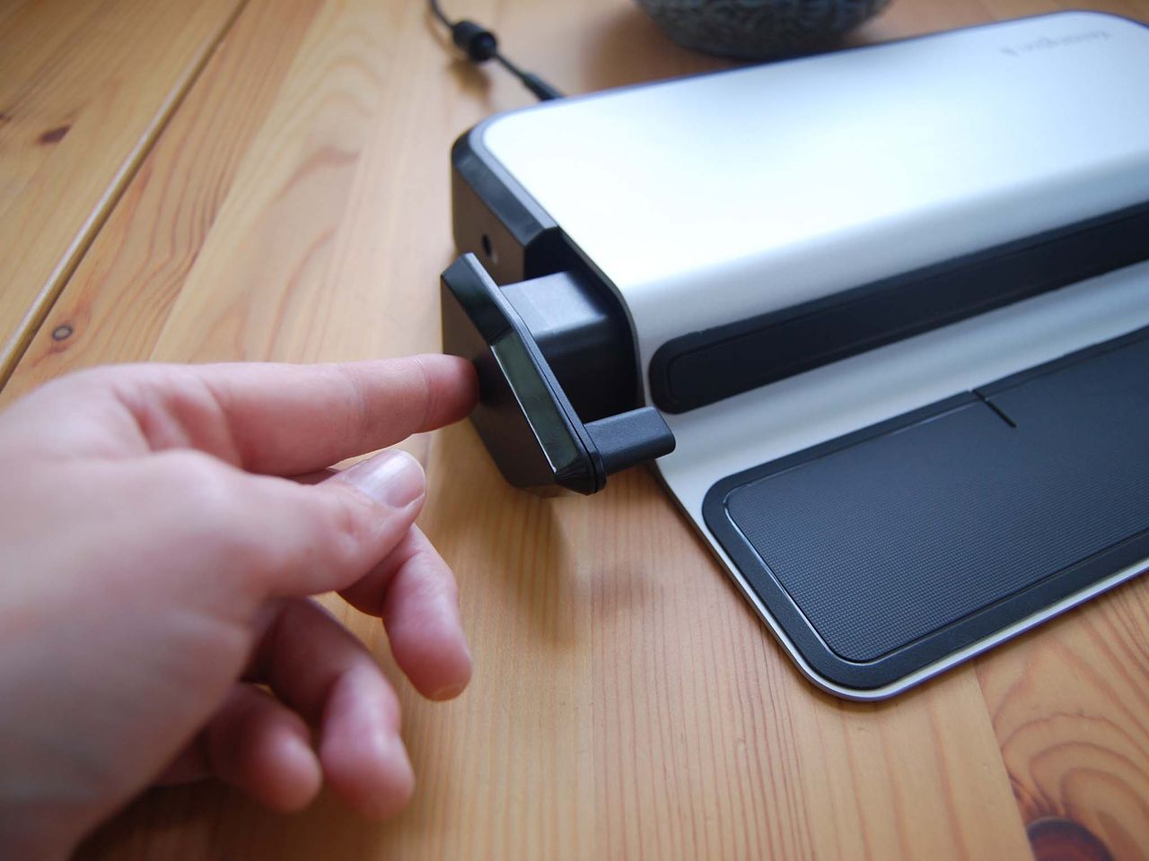

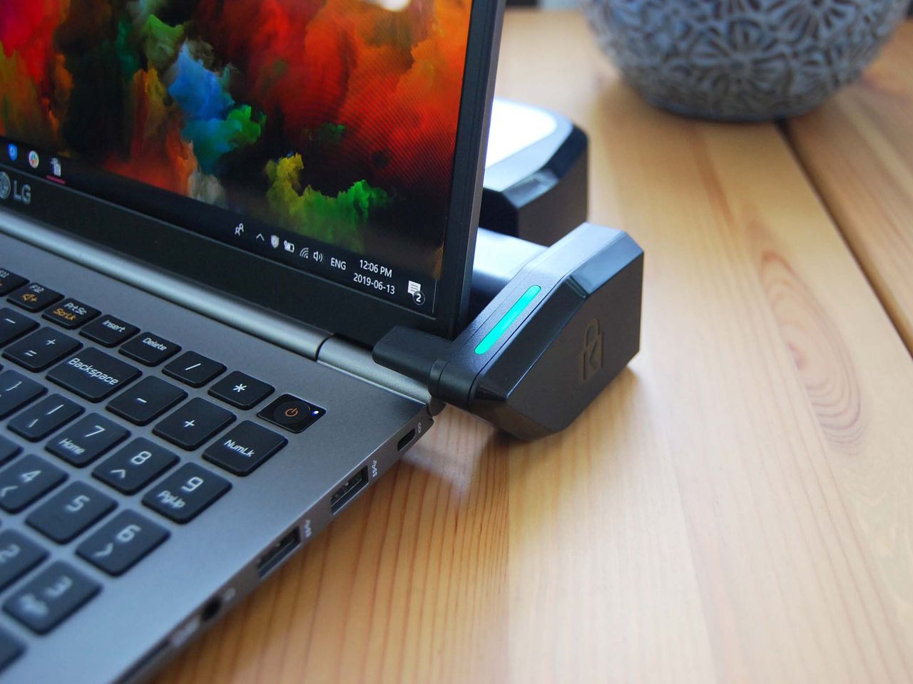

An aluminum plate runs along the top of the dock and extends out to a ledge on which your laptop sits. Rubber pads coat the portions of aluminum your laptop touches to reduce sliding and scratching, and the adjustable arms on either side also have a rubber coating where they touch the laptop. The arms are opened with a "K-Fob," a small plastic fob that is recognized only by your dock. With the dock plugged into AC power, you just wave the fob next to the right arm to have both sides open automatically thanks to an internal motor. The arms are made of plastic, but they're thick and strong enough that no one is going to bend one back to free the laptop.
The arms close with a bit of pressure, clicking audibly past lock spots that can't be reopened without a fob. I had no trouble securely fitting my 15-inch laptop, and Kensington claims it should also work with devices as small as 11 inches. This is strictly a Thunderbolt 3 dock, so if your laptop doesn't have one of these ports, you'll no doubt want to look elsewhere.

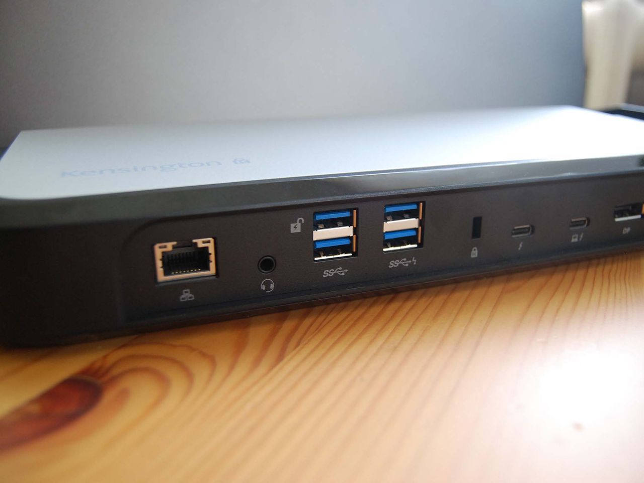

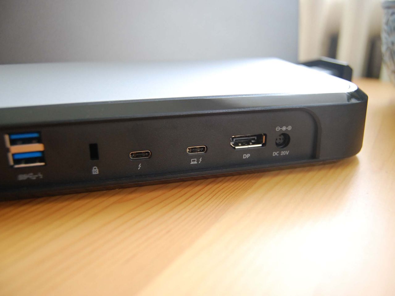

The LD5400T brings a total of eight ports (not including the host Thunderbolt 3) you can use when plugged in, enabling a secure workstation experience. Ports include RJ45 Ethernet, four USB-A 3.0, secondary Thunderbolt 3, 3.5 mm audio, and DisplayPort 1.2. Those of you with high-resolution ambitions can connect up to a single 5K display and get a 60Hz refresh rate, or dual 4K displays also at a 60Hz refresh rate. All ports are spaced well enough that there should be minimal congestion, and cables can easily run off the back of your desk for a cleaner look.

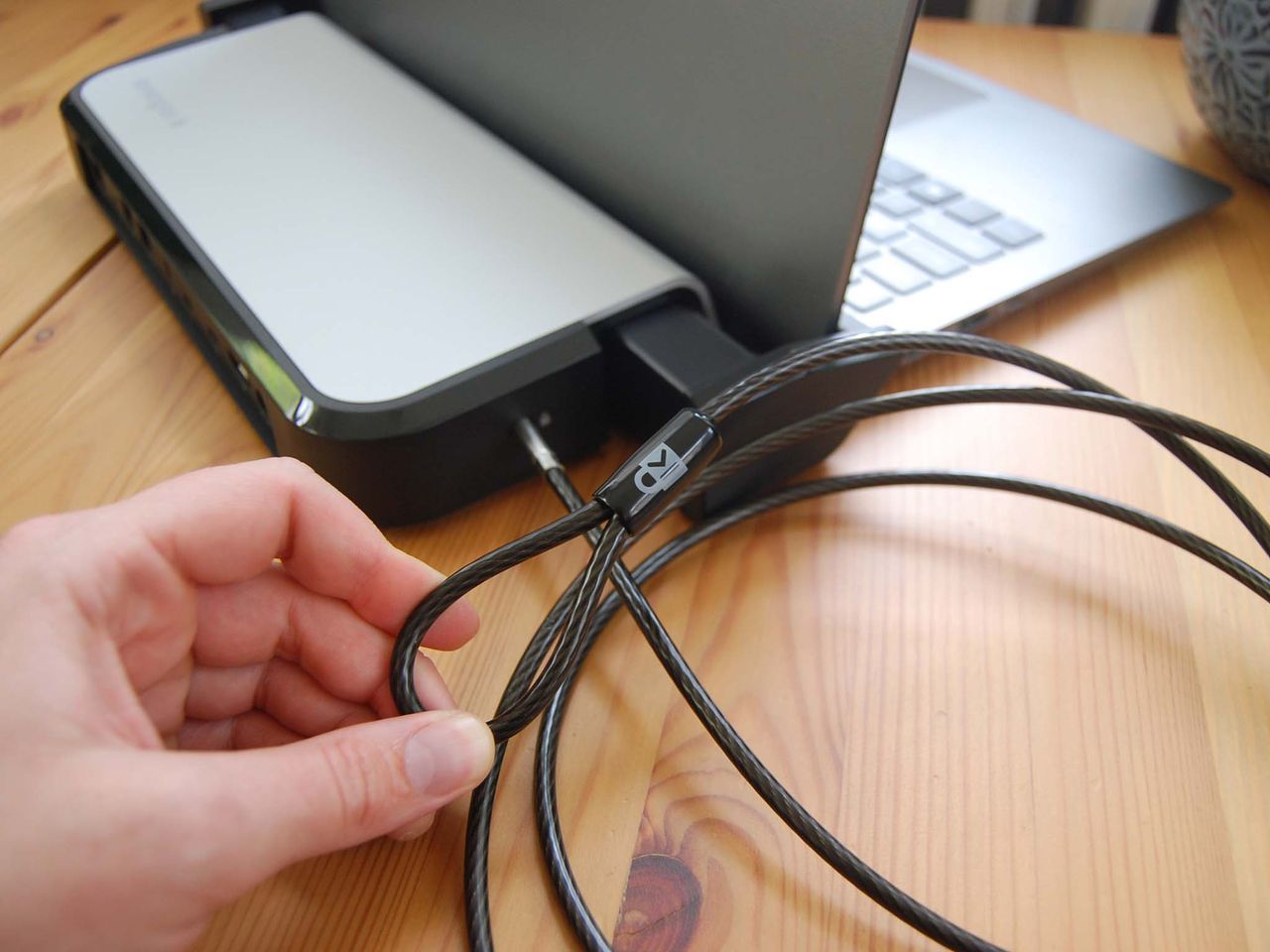

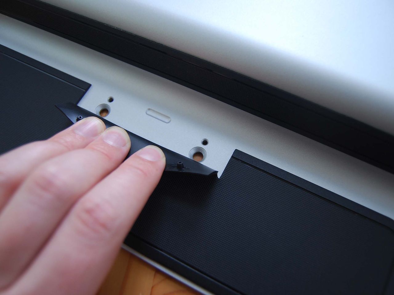

The laptop is securely fastened to the dock with the extendable arms, but what keeps the dock from walking off when you're not around? On the back panel among the ports is a standard Kensington lock slot that works with any desk's built-in cable, below the rubber padding on the aluminum ledge are two screw holes for permanently attaching the dock to a desk, and on the left side of the dock is a hookup for an included six-foot tether cable that can wrap around essentially anything. While these probably aren't completely tamper-proof — except maybe for screwing the dock into the desk — they make strong deterrents for any would-be thieves.
