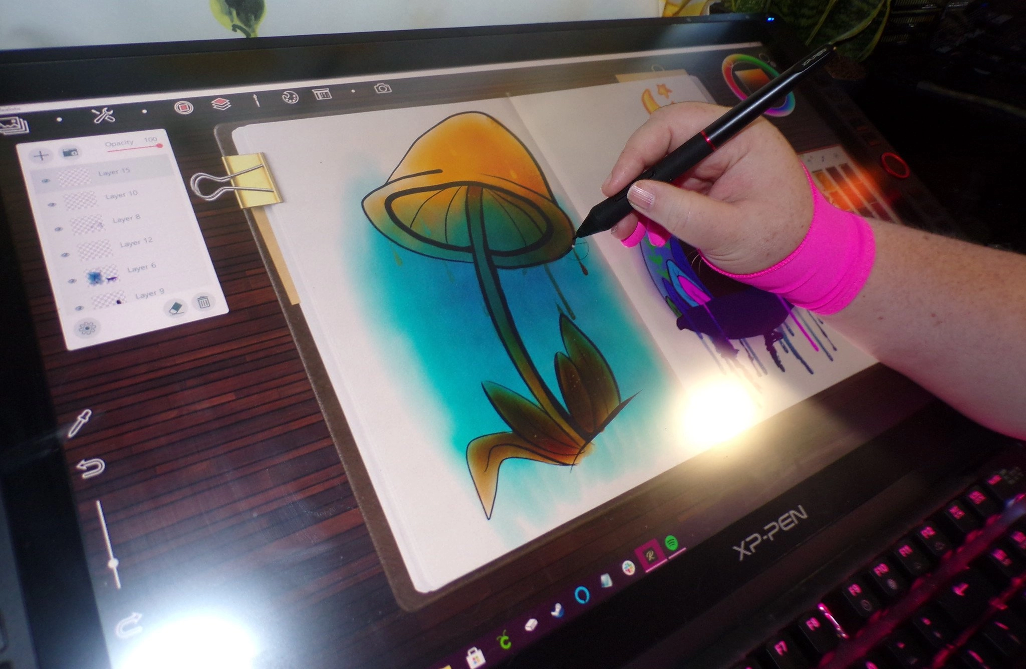

The XP-Pen Artist 24 Pro display features a 2K resolution at 60hz, making it perfectly suitable for use as a primary display for one monitor set up. However, it is worth pointing out that the Artist 24 Pro does not have a fully laminated screen. Fully laminating a pen display helps lower the parallax, that distance between the drawing under the screen and the tip of your stylus, which can help make you feel more like you're drawing directly onto the image rather than pushing the drawing through the glass. There is lamination on the screen, but there is also a thin layer of glass that increases that parallax but not to a disorienting degree.
The existing lamination on the Artist 24 Pro does provide some nice features, though. Primarily, it helps to reduce the glare on the monitor. Glare was an issue I dealt with quite a lot with the Huion GT 220 v2 I used previously, as it had no lamination whatsoever. If the overhead lights or my desk lamps were on in the room, the glare from the Huion would make it nearly unusable. The Artist 24 Pro, in contrast, does more to diffuse the glare from these lamps when they're on in the room and I'm working. In addition to the anti-glare properties, the monitor also has a nice feeling of 'tooth' to it, giving the pen a little more grip that makes it feel more like drawing on paper.
The outer bezel of the Artist 24 Pro is a nice matte black to reduce fingerprint smudging. It includes 20 customizable hotkeys and 2 red-ringed rotary wheels that can also be customized in the monitor's driver UI. The use of express keys can be a hot button topic among pen display users, but personally, I found them to be a nice addition. Because of the 24 Pro's large size, I often had to move my keyboard out of the way to use it properly, so having the express keys to fall back on kept me from having to reach for the keyboard whenever I wanted to do something as simple as undo.
The customizable rotary wheels have a metallic red ring, which is a nice eye-catching design that also helps make the wheels visible in your peripheral vision while you're focused on drawing. Because there is no touch support for the Artist 24 Pro, the rotaries give you the option to have canvas zoom and brush size with just the touch of a small dial. Having the wheels on each side of the display means they're suitable for left and right-handed users alike. Previous iterations of these displays forced users to choose whether they wanted to use the left or right-hand side's express keys, but this 24 Pro removes the stipulation and lets the user decide to use any or all of the keys on their own discretion.
Along with the monitor and necessary cables, the Artist 24 Pro comes with not just one, but two battery-free pens, a handy pen holder, and eight replacement nibs that — despite all my years of digital art — I have never once needed. Each pen features the rubberized grip on the lower half of the barrel, similar to what is used on the feet of the monitor and stand, and the metallic red ring element seen on the rotaries, which is a nice design touch. The pens also feature a rocker button that can be customized and is typically best used to swap between your brush and eraser tools on the fly.
Speaking of the eraser, that is the one element that I miss the most on these budget pen displays. More expensive devices from Wacom and Xencelabs often include an "eraser" button, allowing you to casually flip the stylus to erase, like a traditional pencil, and then swapping dynamically back to the brush when the tip returns to the screen. The stylus for the Artist 24 Pro does not have this eraser button; you're left to just tie up your pen barrel buttons with this function. That doesn't stop me from trying to erase with the end at least once per painting.

Whether you're using Sketchable or Adobe Illustrator or all the possible apps in between, you're going to be able to rely on the Artist 24 Pro to work and work well. There are minimal pen jitter thanks to a combination of the battery-free stylus and the size of the monitor allowing for large sweeping pen strokes. What little jitter did exist was easy enough to smooth out with brush settings.
However, it's not exactly a flawless drawing experience, as there were instances in Corel Painter 2019 where an odd "spike" mark would be left at the end of a stroke after lifting the pen from the screen. I was unable to recreate this issue in Krita, Sketchable, or Realistic Paint Studio, so it may be limited exclusively because I was using an older version of Painter 2019. At most, this was a minor inconvenience where I could just go back, erase the extra spike and continue working. The driver UI and software are also frequently updated, so it's likely that if this is a driver-related bug, it could be worked out in the future.
