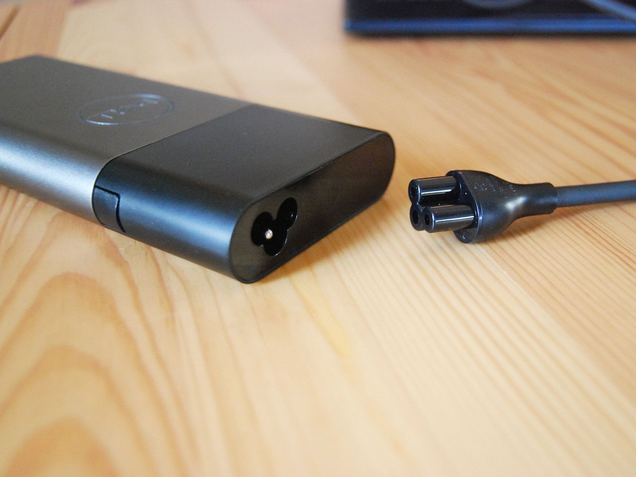

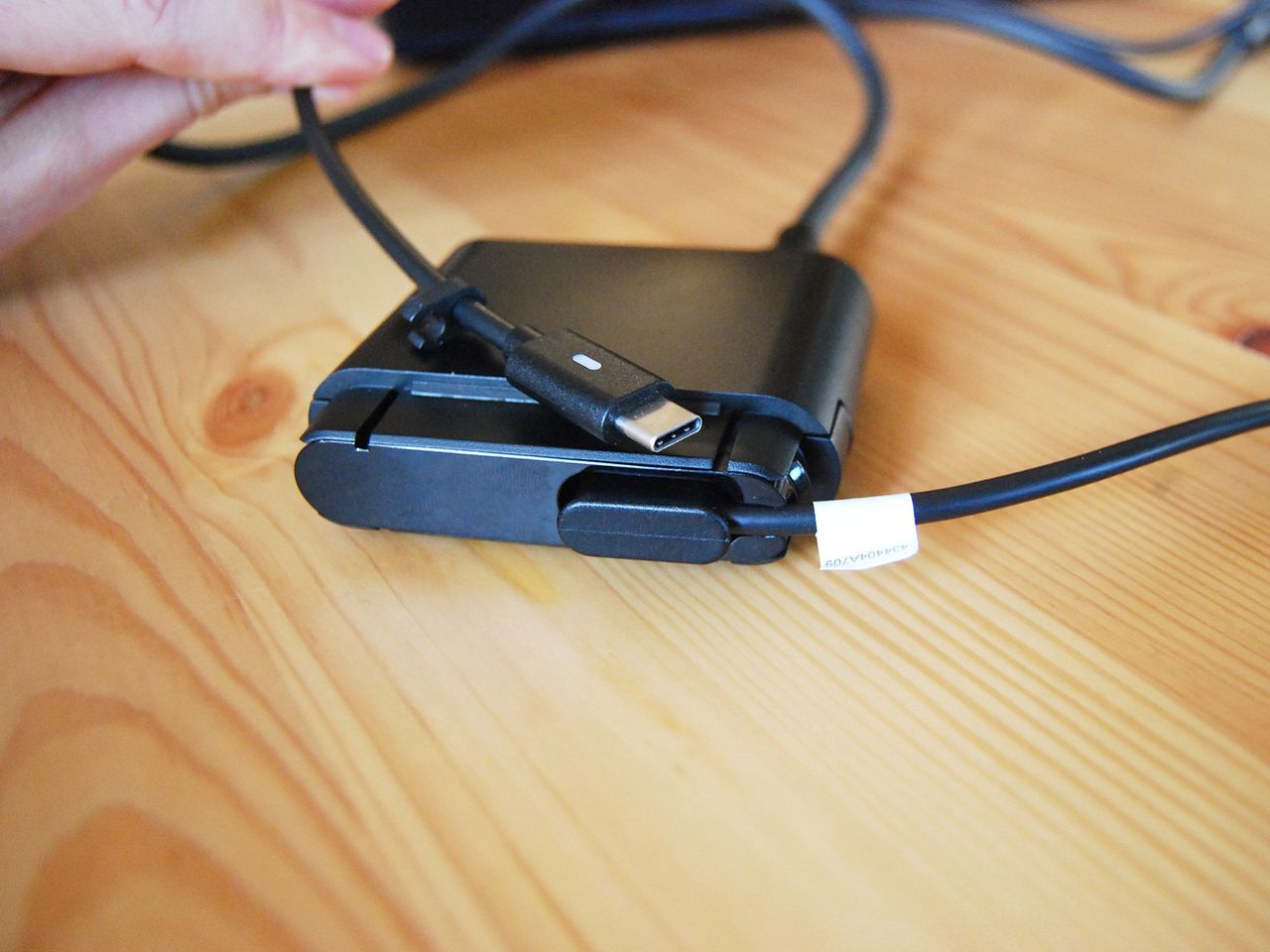

The hybrid aspect of the power bank is the detachable 45W power adapter. It's used to charge the battery pack itself, but thanks to the smart modular design of the USB-C cable (and really the whole product), it can also be used as a charger straight into your laptop. Dell's idea here is that the added weight of the power bank won't make as big of a difference when you can leave your regular adapter behind. It's compact, lightweight, and at 45W it can deliver a good amount of juice even if you're used to the benefits of a larger adapter when you're at home or at the office.

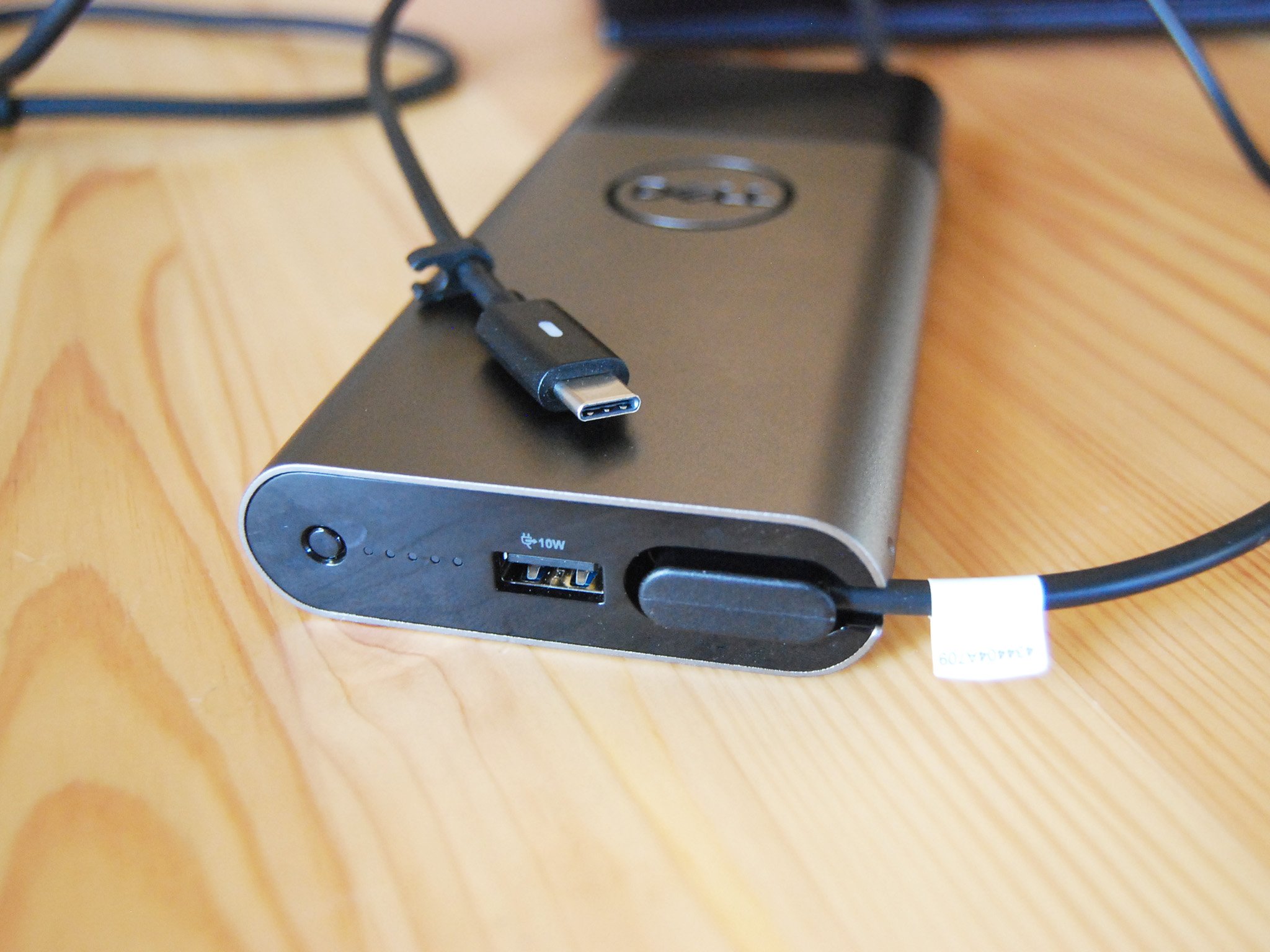

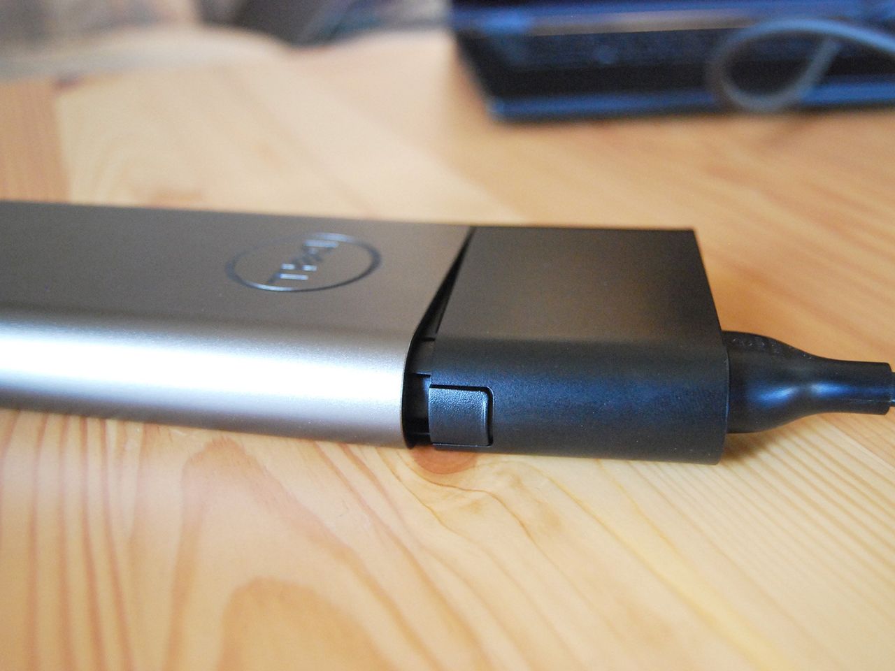

The power bank is designed to be about as slim as possible, with rounded sides that allow it to easily slip in and out of the pockets of your laptop bag. Because it all comes apart, it easy to stow away wherever you have space, and since you have the option to leave your standard adapter behind, it will overall take up less space. However, build quality is questionable. The black adapter piece has two pressure points that are intended to release it from the battery, but they're useless. You can pull the two pieces apart quite easily without pressing anything, and I can imagine a scenario where you're running out of time and realize that the battery hasn't been charging because the two pieces came apart.

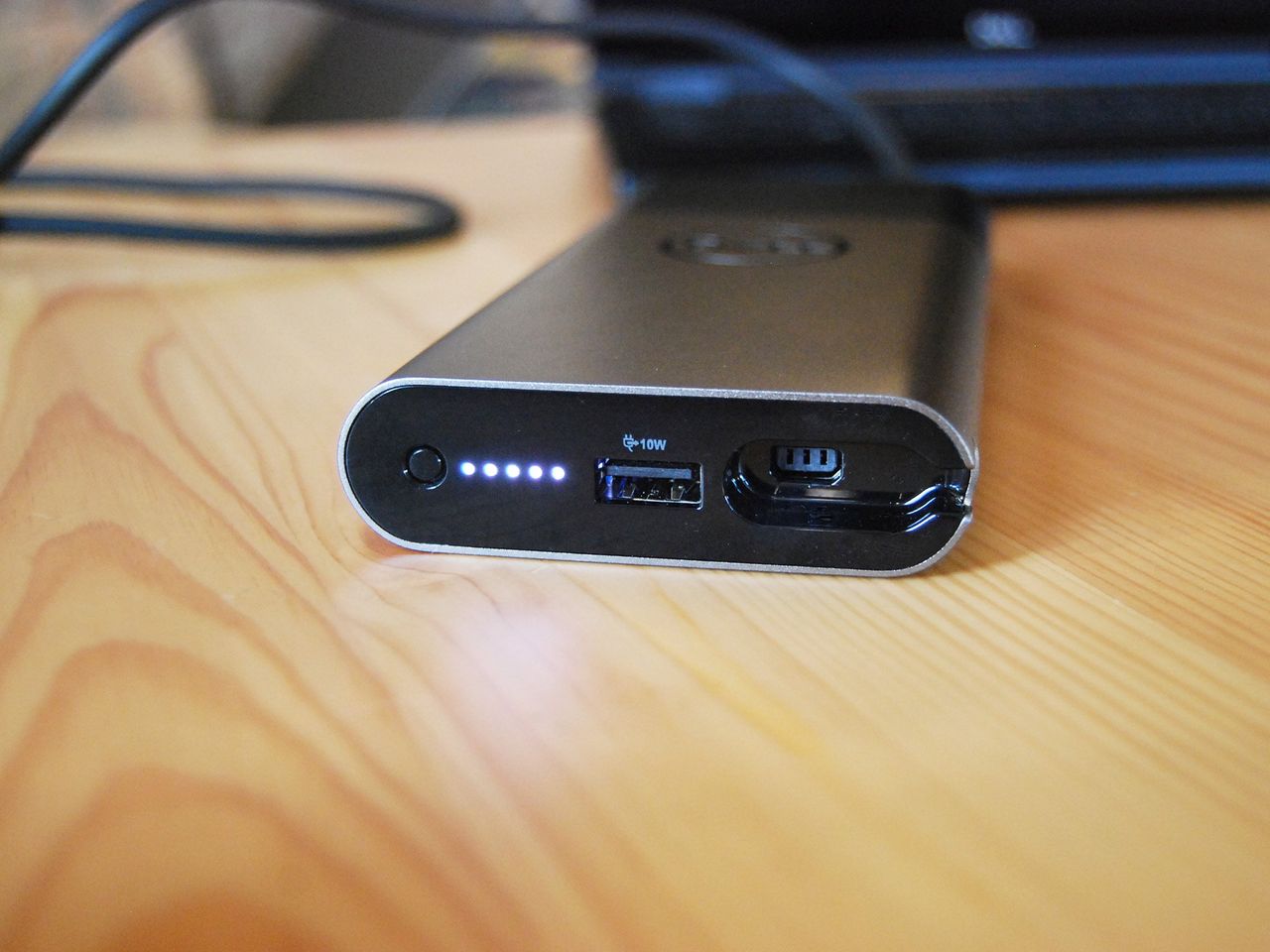

On the bottom of the battery are five small LEDs that show remaining power, a button to display the LEDs and to "wake" the battery pack, and a single USB-A port with 10W of charging power. Yes, you can charge your phone while also charging your laptop — though capacity will be split — but it would be nice to see two USB-A ports, especially when most people have more than one extra gadget when traveling.
