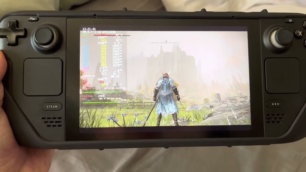

The root cause of the problems with Project Killswitch are related to the magnets used to attach a kickstand to the case. The Verge noticed that the magnetic kickstand of the case was slowing down the Steam Deck's fan. The outlet spoke reached out to dbrand, and the two worked together to determine the cause of the peculiar problem, along with some help from well-known YouTuber Dave2D.
The Verge shared a video of the Delta fan being affected by the Killswitch kickstand.

It seems that the magnetic kickstand only affects Steam Deck units with a Delta fan. The problem is that people cannot tell if their device has a Huaying fan (which is seemingly unaffected by the magnets) or a Delta fan without cracking their Steam Deck open. That's not a reasonable action for dbrand to ask of people, so instead, the company is handling all orders the same way.
