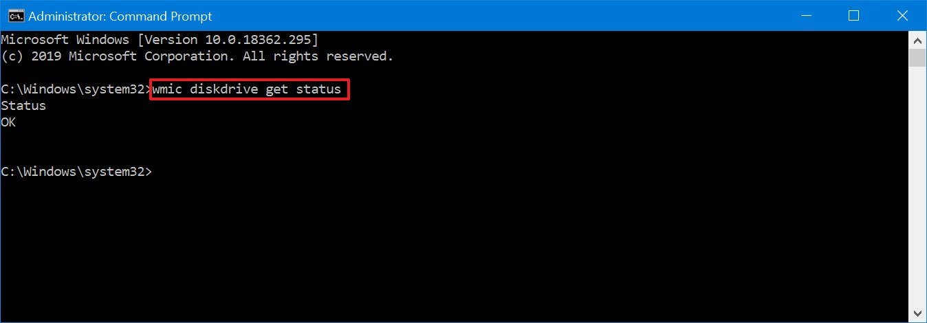

To quickly check the SMART status with the Windows Management Instrumentation Command-line (WMIC) utility, use these steps:
- Open Start.
- Search for Command Prompt, right-click the top result, and select the Run as administrator option.
- Type the following command to determine if the hard drive is failing and press Enter:
wmic diskdrive get status
- Under the "Status" column, confirm that the result is OK.Quick note: You'll see an OK status for each internal drive installed on your device.
Once you complete the steps, if the status reads OK, everything is working as expected. If the status reads "bad," "unknown," or "caution," it's likely that the hard drive has an imminent hardware failure, or the command is having problems querying the status from the firmware of the drive.
