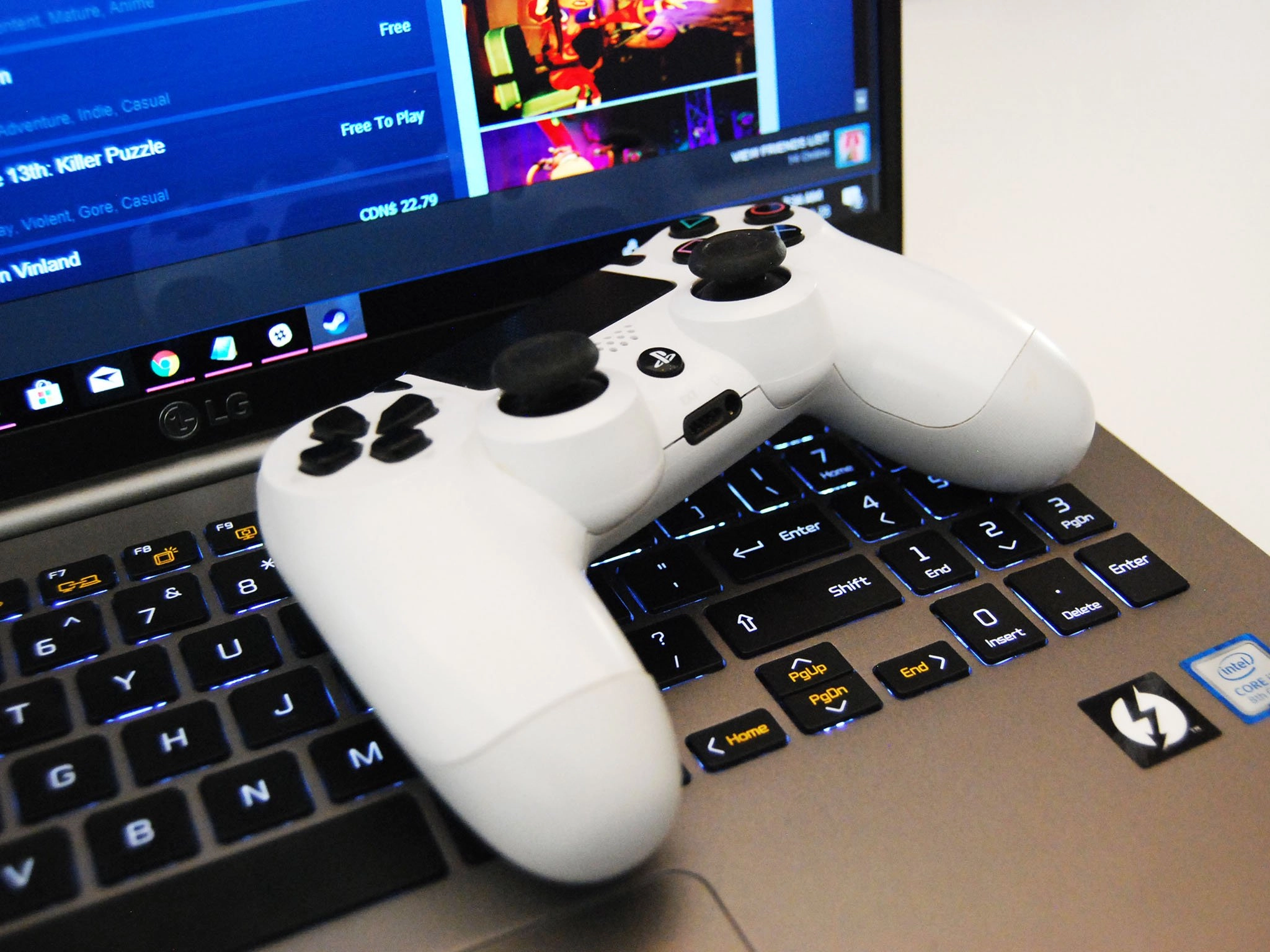

How to connect a PlayStation 4 controller to your PC
Windows 10 and Xbox are understandably great bedfellows, and it's easy to use your Xbox controller across the two platforms. However, many people have a PlayStation 4 (PS4) lying around, complete with a DualShock 4 (DS4) controller. Whereas connecting the DS4 to a PC was once a bit of a nightmare, it's now pretty easy thanks to better software integration. Here's how to get the two working together and how to use the DS4 in a couple of different scenarios.
