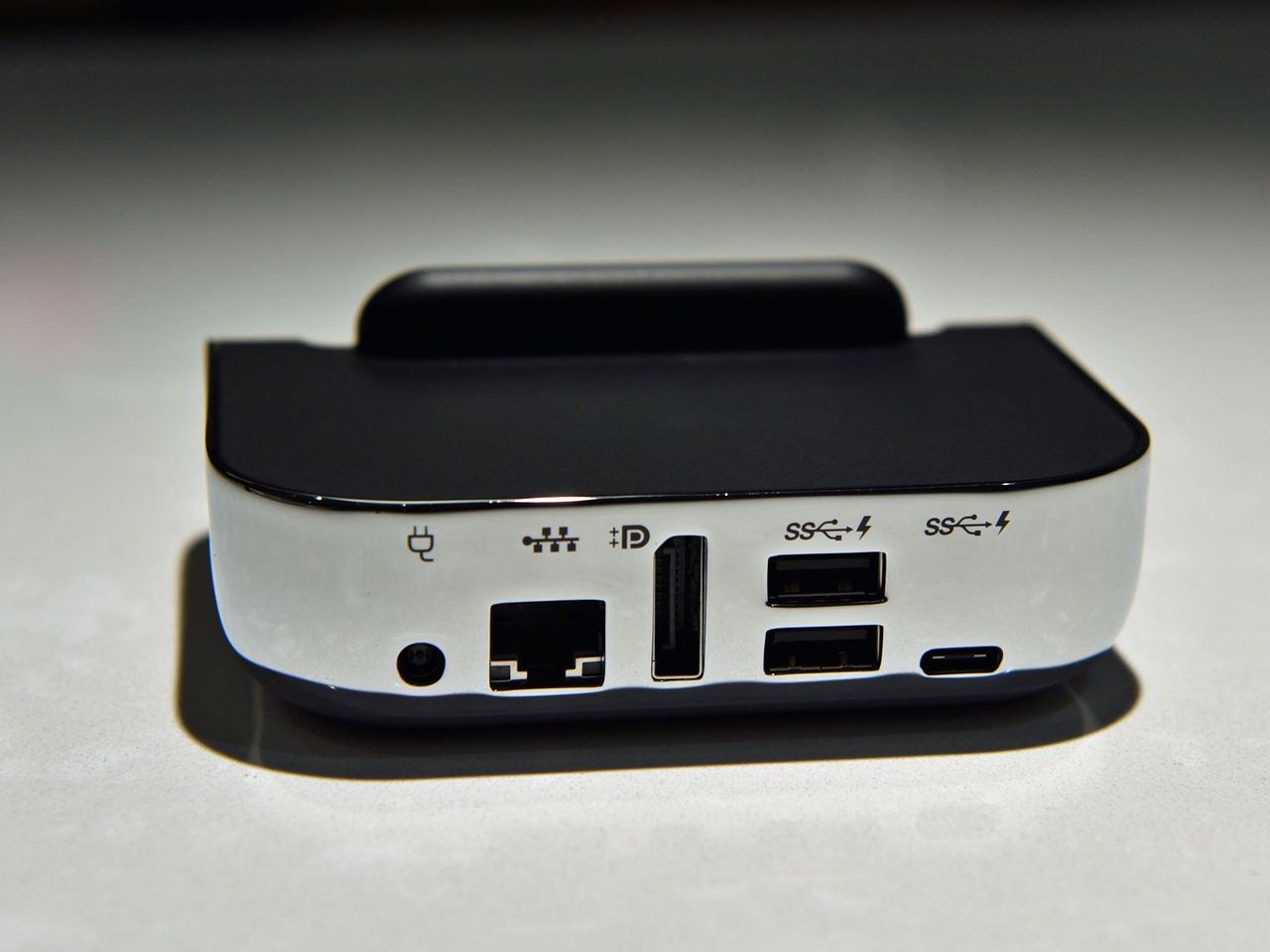

| Ports and Connectors | 1 DisplayPort 2 USB-A 1 USB Type-C 1 RJ-45 1 AC power |

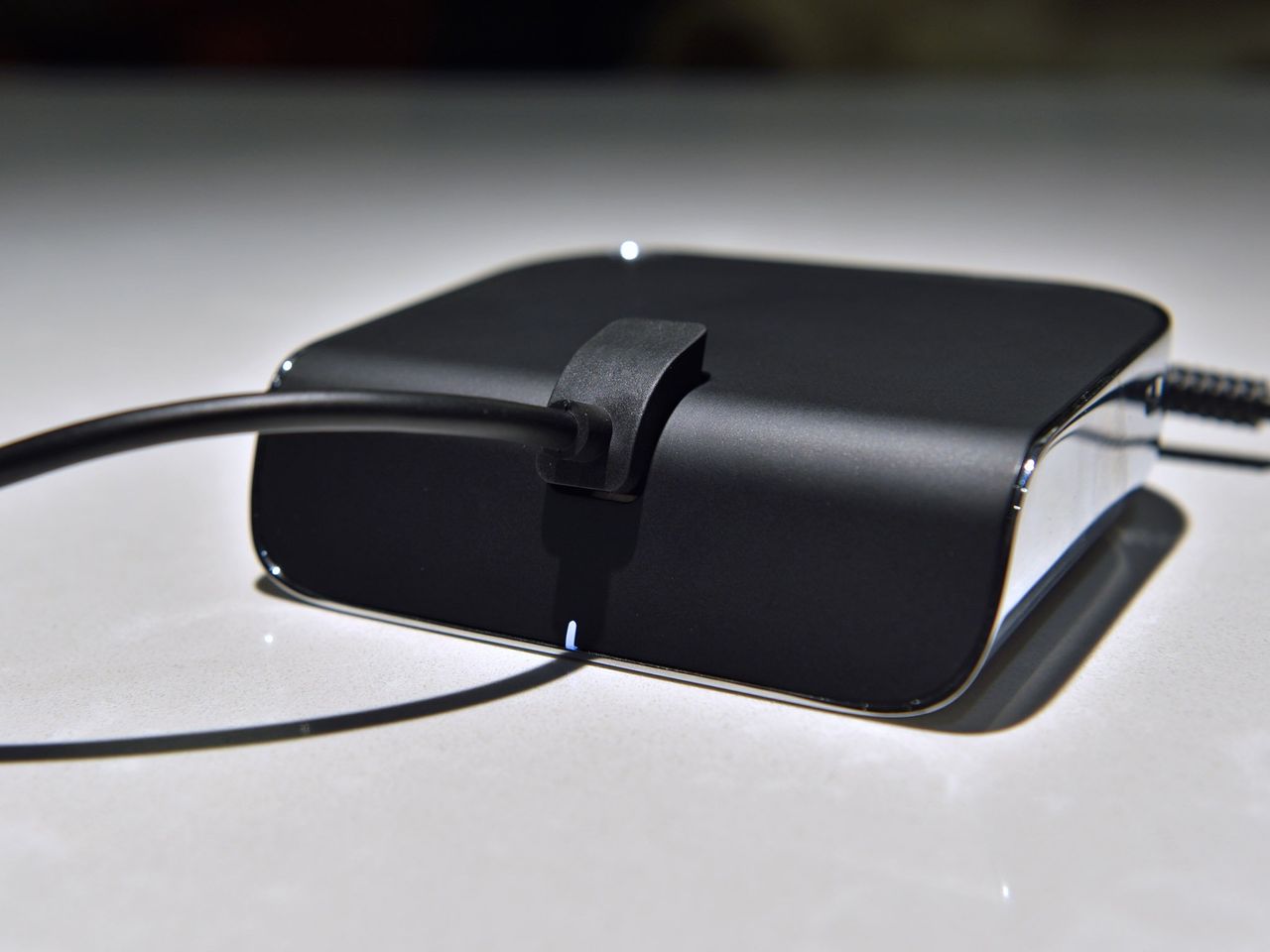

| Power | 45W (5.25V/3.0A) power adapter with 1.5m cord length |

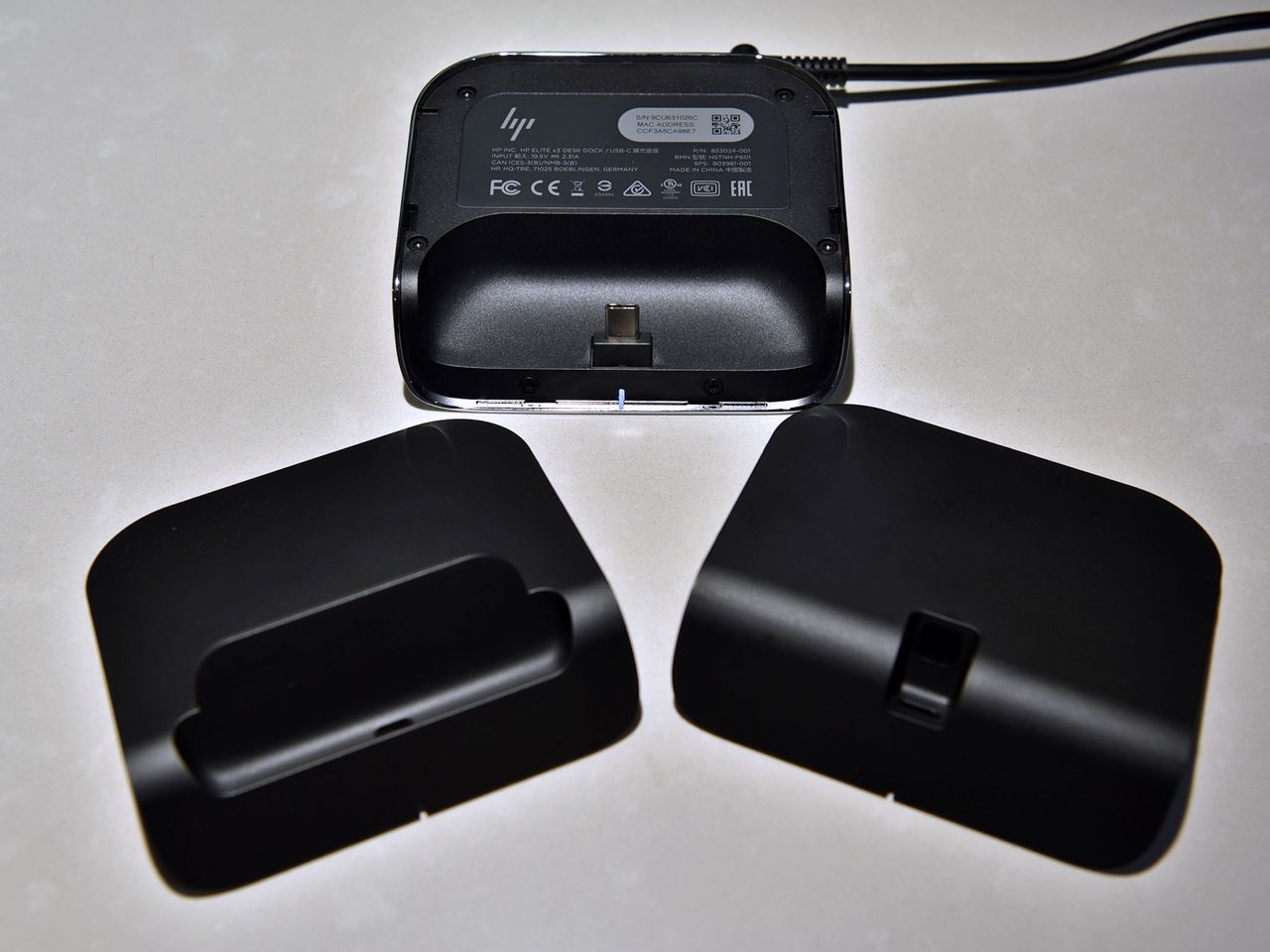

HP solved this by including a few interchangeable shells for the Desk Dock. That is why you can put an HP Leather Folio on the Elite x3 and still slide it into the Dock. There is also a shell for the Rugged Case (our review is coming next week).

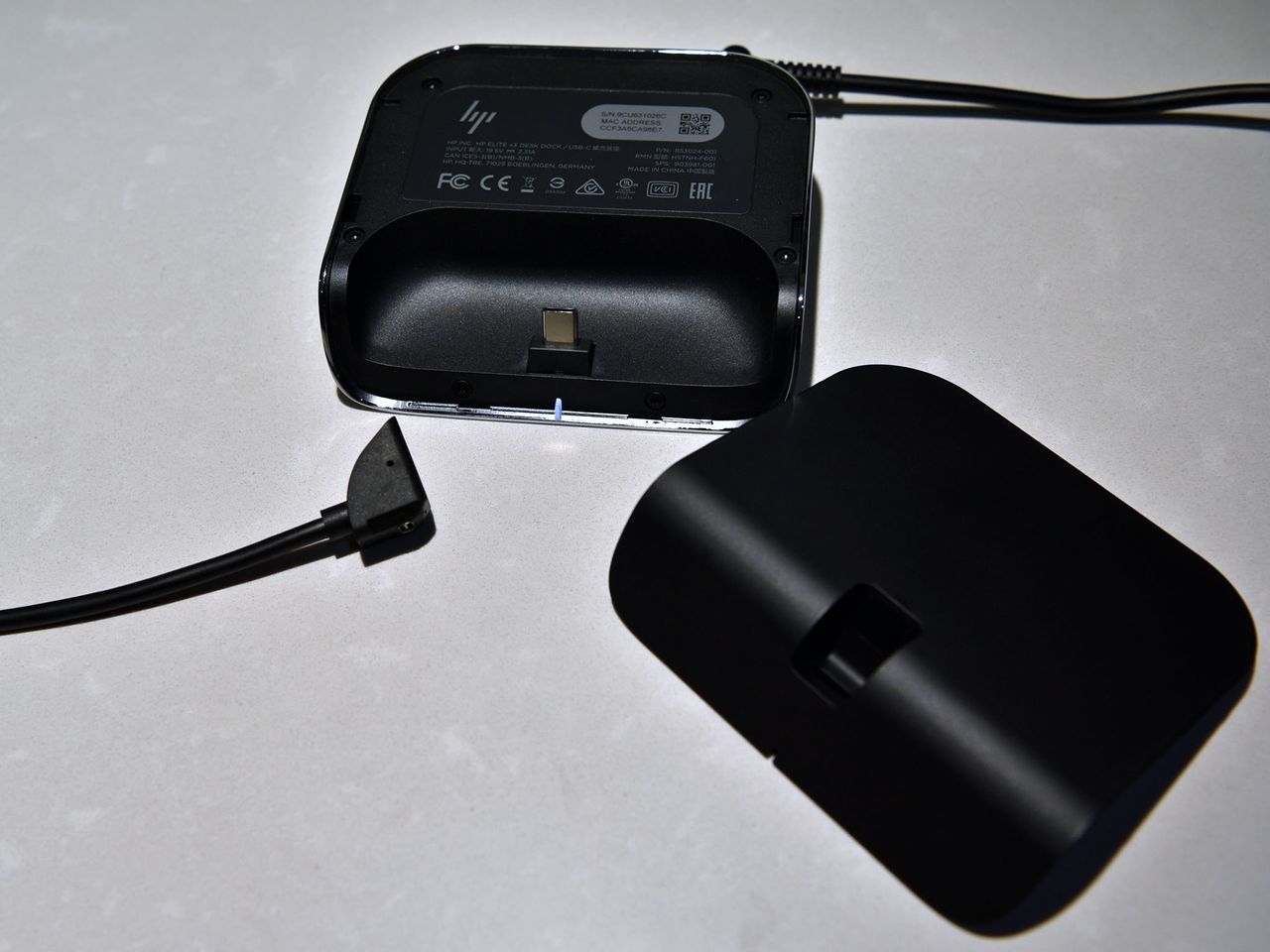

But what if you don't want to use the HP Desk Dock as a holder for your phone? There's an additional shell that extends the vertical dockable USB-C plug into a cable ending in a USB-C plug. So if you prefer to plug in your phone and leave it flat on the table (like with the Microsoft Display Dock), then you can. These shells are all magnetic, so swapping between them is a no-tools affair.

The HP Desk Dock also includes a built-in RJ-45 Ethernet Port, and it uses a Display Port for video instead of the more common HDMI port found on the Microsoft Display Dock.
