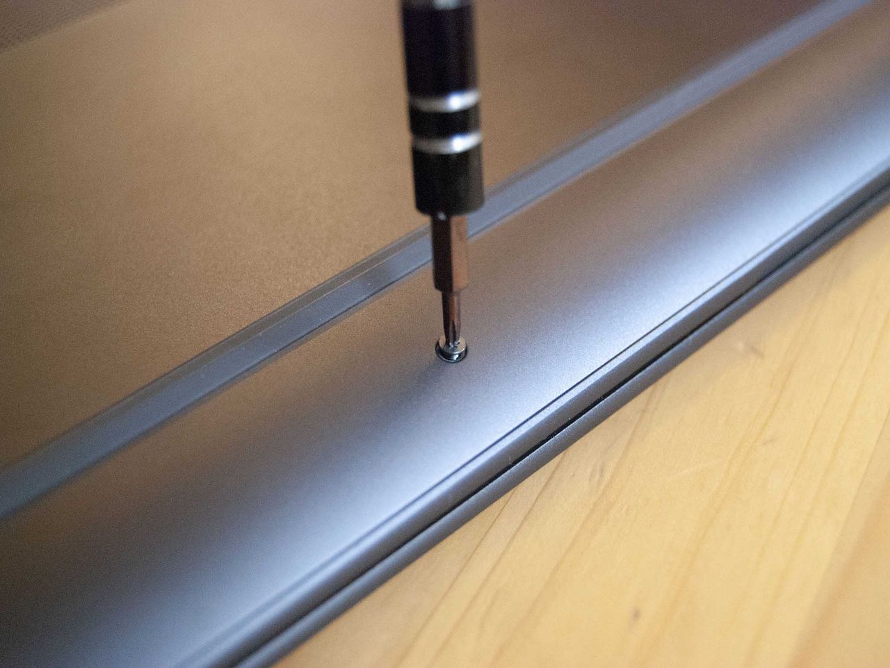

- Using a screwdriver, remove the screws holding the backplate of your laptop in place.

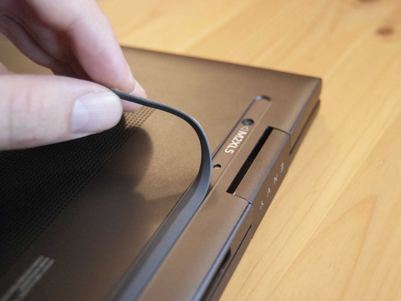

- If your laptop has screws being covered by rubber feet, carefully peel the feet off to access and remove the screws.

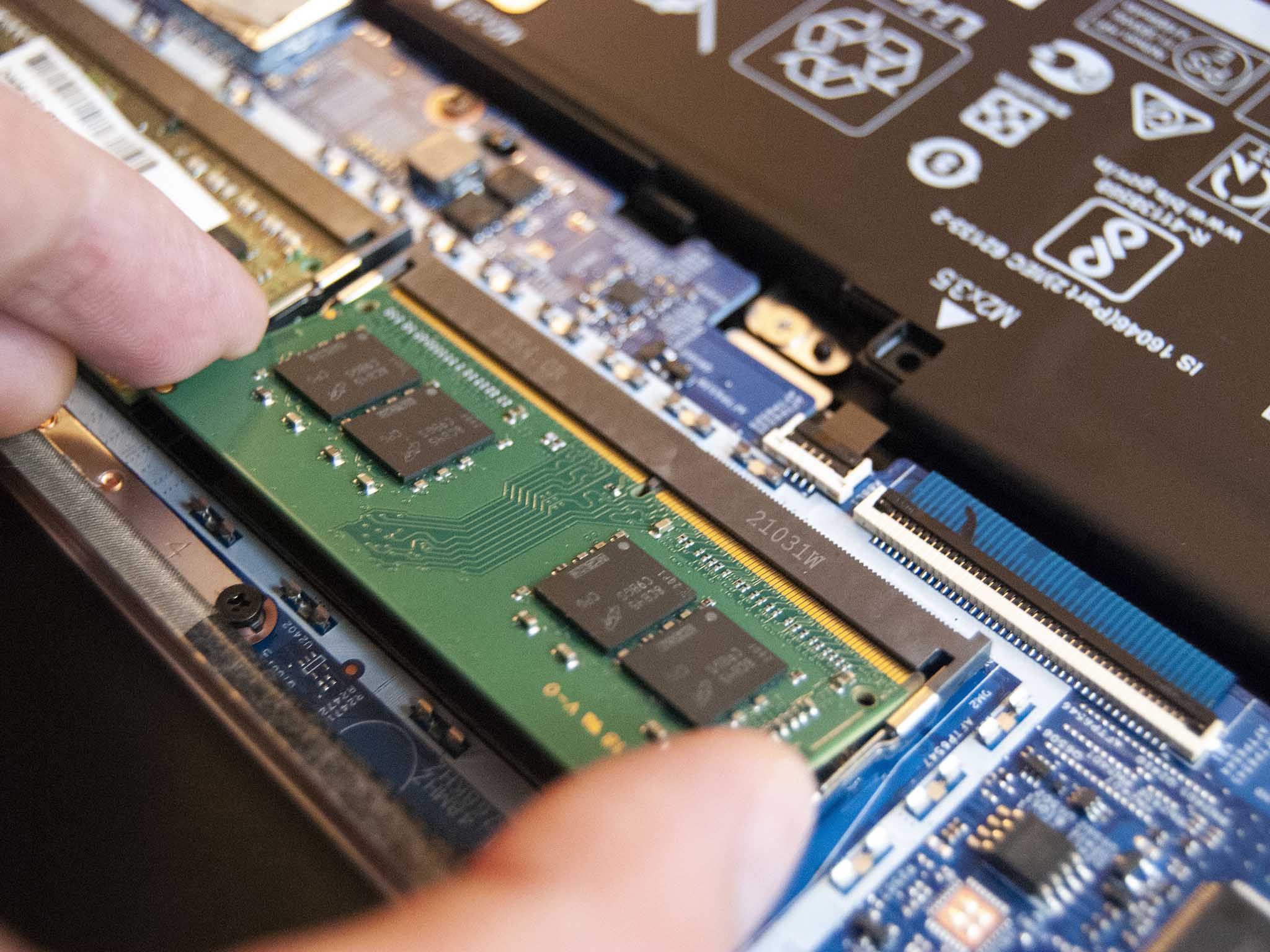

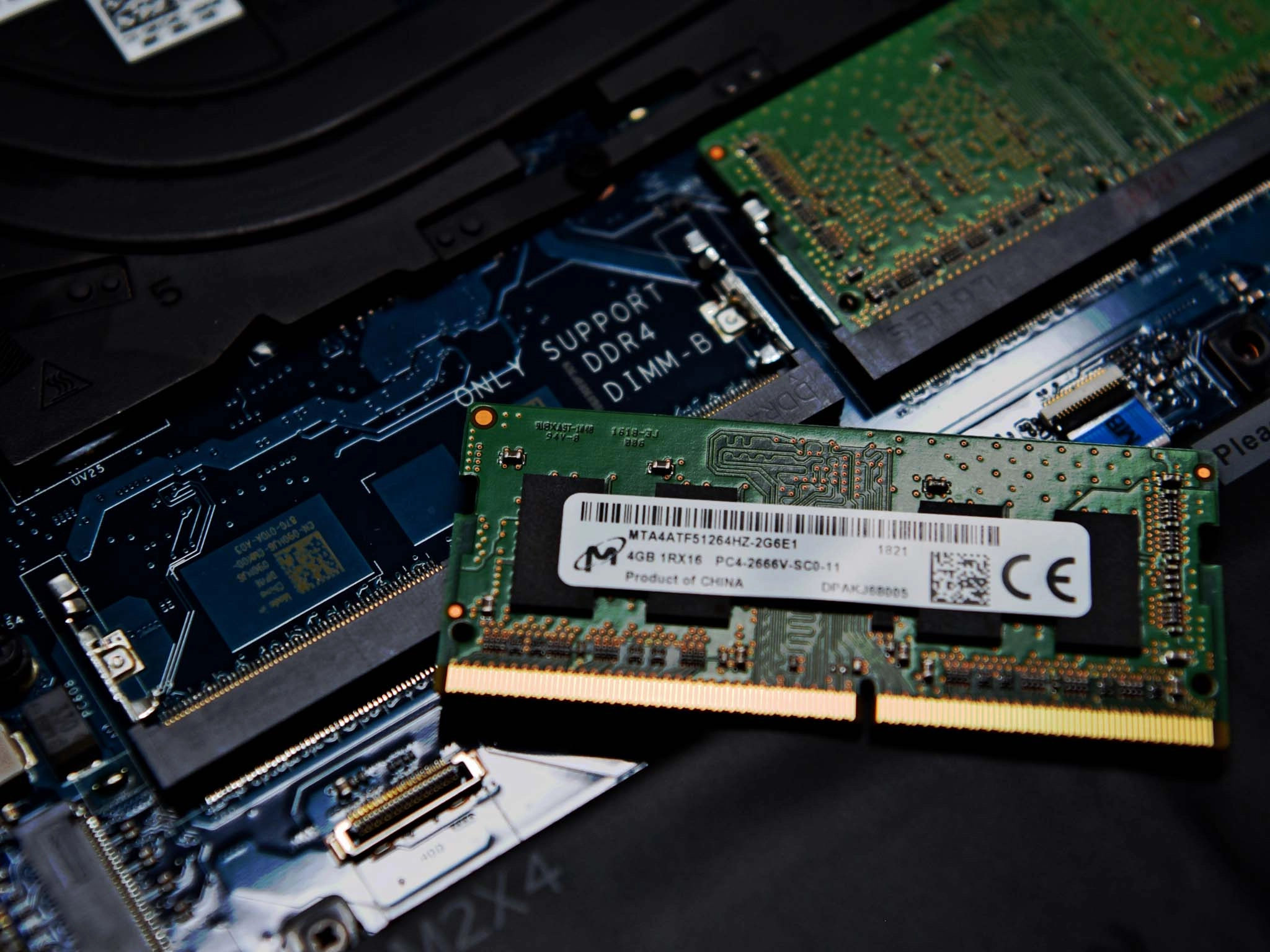

- On the sides of the RAM, look for clamps or metallic arms that are keeping it in place. Gently push these away or unfasten them to free the RAM. In some cases, the RAM will partially pop out when you do this.
- Gently pull the RAM out of the slot. Pulling straight up can damage the RAM or the laptop, so pull at an angle instead.Source: Windows Central
- Gently push the new RAM into the slot. Push until you hear an audible click that indicates the RAM is installed. Repeat steps 4-7 if you want to replace the other RAM module in your laptop.
