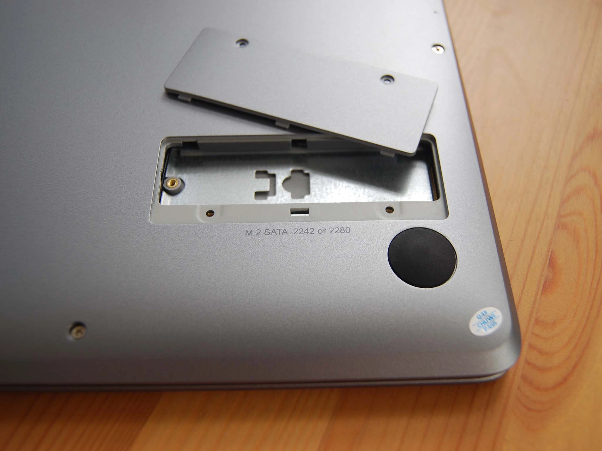

CHUWI's 14.1-inch HeroBook packs a lot of PC into a $200 package, though the stock 64GB of eMMC storage is a weak point due to speed and size. Luckily, the HeroBook has a quick-access panel on the bottom of the chassis that hides an M.2 SATA solid-state drive (SSD) slot for extra storage and improved performance.

All HeroBook configurations available from CHUWI come with 64GB of eMMC storage with room for expansion through the microSD slot or the M.2 SATA SSD slot. While a quality microSD card is an affordable and convenient way to add up to 128GB of space, an M.2 SATA SSD provides up to 1TB of extra storage and can be used for quicker Windows 10 boots and overall improved performance.
While you can install an M.2 SSD and use it for storage only — you'll need to format the drive to have it recognized by the system — we recommend cloning the data on the eMMC storage, including Windows 10 and your apps, over to the new SSD. We've had success with Macrium Reflect and have written a complete guide to help you with the process. Once you've cloned the eMMC drive over to the new SSD, you can change the boot order through the system's BIOS so that your speedier SSD is accessed first.
Once you've backed up up your data, clear out a clean and well-lit working space, power down your HeroBook 14.1, and proceed with the steps below.
- Unscrew the two fasteners on the bottom quick-access panel using a Philips-head screwdriver.
- Pry up the access panel using a pry tool or thumbnail. This reveals the M.2 SATA SSD slot.
- Insert the M.2 SATA SSD into the slot at an angle. Position it so that the label is facing up and the flat side of the SSD is facing down.
- Screw in the single fastener at the end of the SSD. The HeroBook 14.1 does not include a screw, though the SSD you purchased should include one. Do not overtighten.
- Replace the access panel by applying a bit of pressure until it clips into place.
- Screw in the two fasteners to secure the access panel in place.
You're now free to boot up your HeroBook 14.1 and check to see if the storage upgrade went according to plan. You'll need to format the drive before it's recognized by the system, and once that's complete, you can go ahead with any drive cloning you choose to do.
