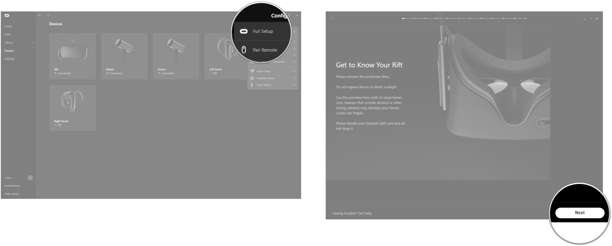

Touch not detected during sensor reset
When resetting sensor tracking within the Oculus app, you might be presented with an error that says "We couldn't save your position" — this is especially common when setting up room-scale Rifting with three sensors. The cause of this problem might be that not all of your sensors can see your Touch controllers.
First, try moving your Touch controllers around and reposition your body so that all three sensors can see the controllers. If this doesn't work, you'll want to run a full setup again instead of just the "Sensor Setup" option.
- Launch the Oculus app from your Start menu, desktop, or taskbar.
- Click Devices.
- Click Configure Rift.
- Click Full Setup.
- Click Next.
- Click Next.
- Click Touch.
- Click Next.
- Click Next again and follow the on-screen instructions to complete the setup.
Now that you've run through the full setup, your Touch controllers should have no problem being detected.
