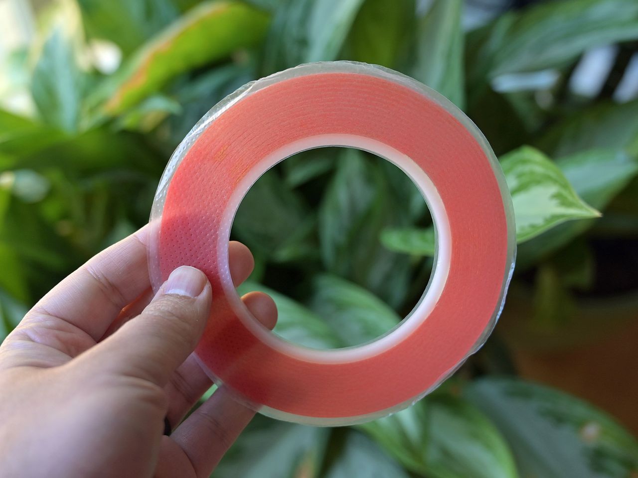

Update: The original 3M tape used here was too thick and has now been replaced by a new double-sided thin acrylic version, which is identical to what Microsoft uses with the bumper from the factory.

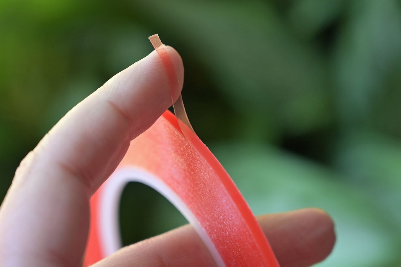

Solving this problem is technically easy: retape it. Luckily, I found five yards of double-sided acrylic tape at 3mm wide and 25 meters in length that seems perfect for the job. The total cost is $7.99 (plus free Prime shipping) and about five minutes of your time.

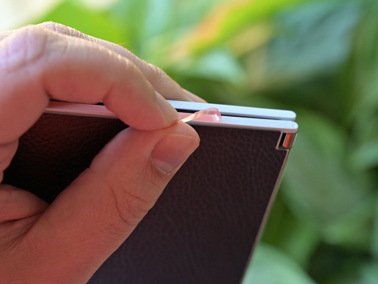

The process is straightforward: remove the old tape from the inner bumper (or your phone). Wipe down with alcohol and reapply to the bumper. Using the old tape as a guide for placement helps, but this isn't rocket science either.
The good news is there is enough left over so you could probably do this action ten more times if you need too. Plus, at eight bucks, this is hardly an investment.

The tape used here is very thin and is made for mobile phones, laptops, tablets, and LCDs for repairs and adjustments. I advise putting the tape on Surface Duo where the bumper makes contact as the tape is too thin to work into the bumper's wedge area. The secondary tape (which is red for visibility) peels back with ease, and as far as I can tell, this is the same type of tape Microsoft uses with the bumper making it a 1:1 replacement.
