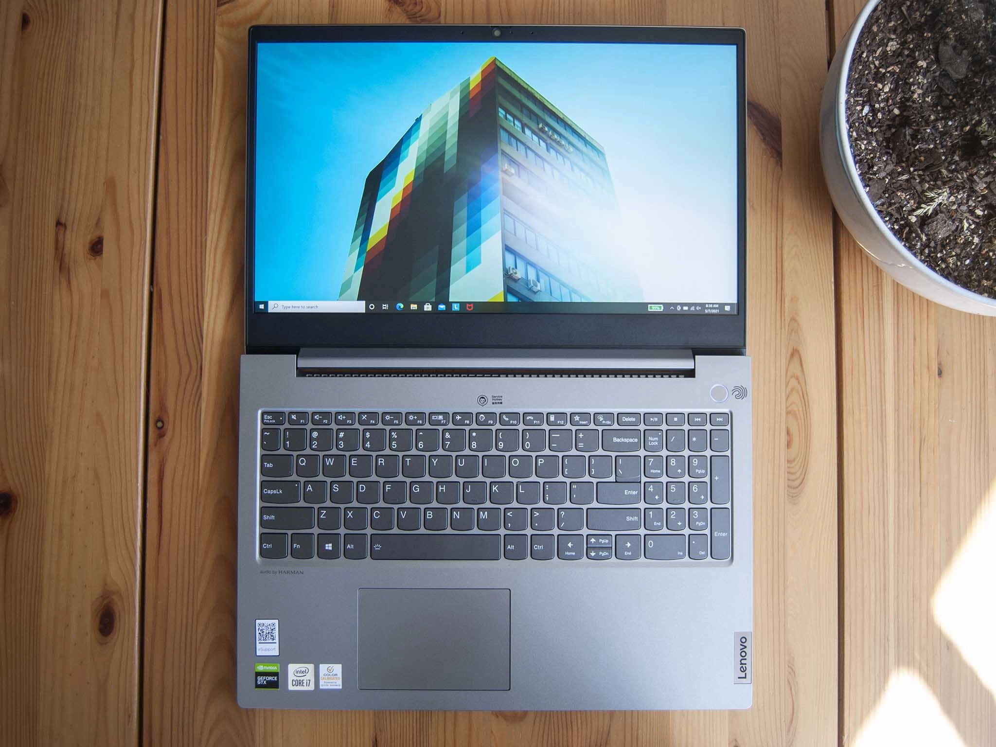

Lenovo's ThinkBook 15p is a powerful 15-inch Ultrabook with 10th Gen Intel Core H-series processors (CPU), up to a NVIDIA GTX 1650 Ti, dual M.2 solid-state drive (SSD) slots, and dual SODIMM RAM slots that can be upgraded after purchase. The system uses DDR4-2933MHz RAM and might come with a single- or a dual-channel setup from the factory. In either case, upgrades are relatively easy and the entire process should take about 20 minutes to complete. Here's everything you need to know about upgrading RAM in your Lenovo ThinkBook 15p.
How to upgrade RAM in Lenovo's ThinkBook 15p
The ThinkBook 15p makes great use of space inside its aluminum body, offering up dual slots each for SSD and RAM. Most models you find will come with either a single 16GB SODIMM module for single-channel setup, or dual 8GB SODIMM modules for a dual-channel setup. That means you'll generally be looking at adding one or two 16GB modules to maximize performance. You can also add smaller modules as you like; both don't have to be the same. For example, if your device comes with one 16GB stick of RAM, you can add 8GB to the free slot for a total of 24GB.

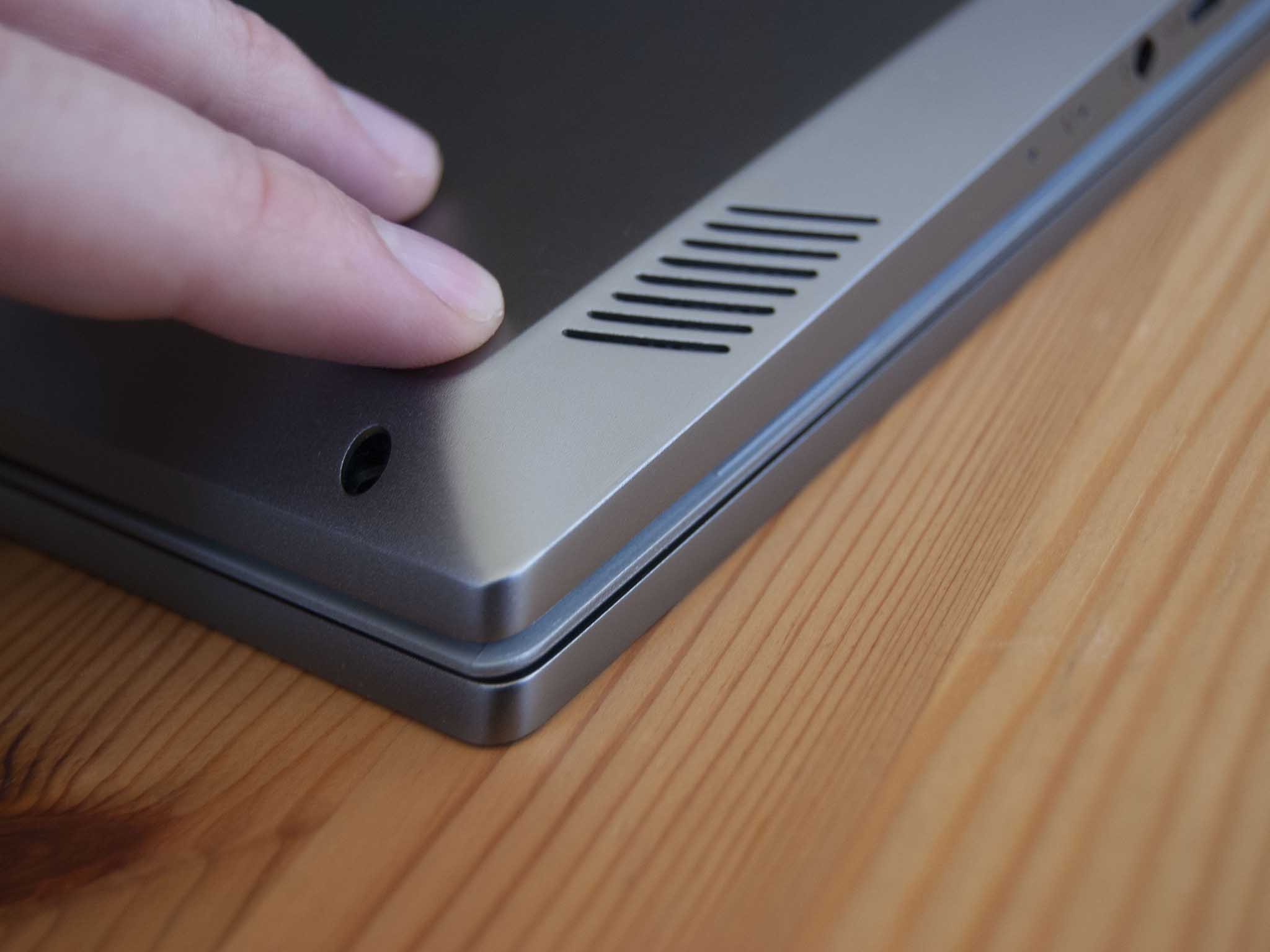

- Unscrew the 10 fasteners on the bottom of the laptop using a Philips-head screwdriver.
- Pry up the bottom panel using a pry tool. Start at a loose point and work your way around. A word of warning here: there are some sharp edges between the body and bottom panel. Take care to not cut yourself.
