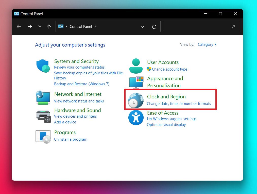

  5. Type control.exe
Control (Image credit: Windows Central)
  1. In Control Panel, navigate to Clock and Region
