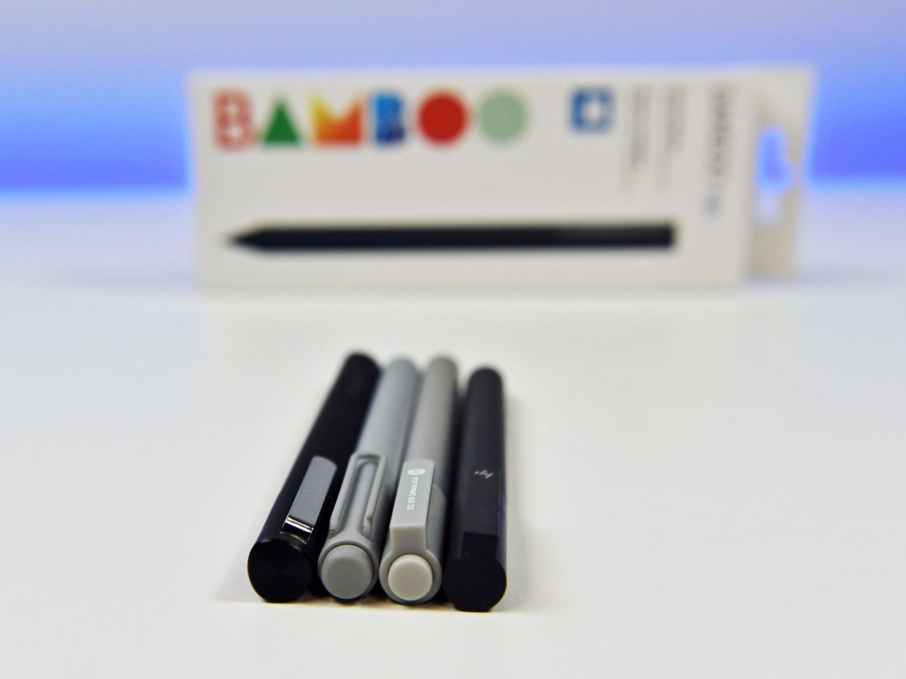

Wacom is also known for having a more triangular shape to its pens versus round barrel design as found in the Surface Pen. However, many artists may enjoy the more ergonomic Wacom design than the Surface's "metal tube" for long drawing sessions.

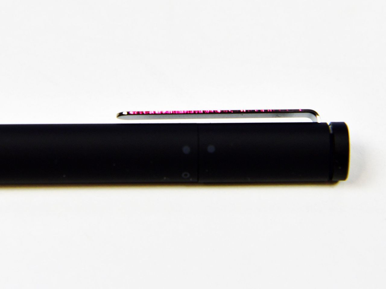

Like the Surface Pen, the Bamboo Ink supports Bluetooth so that users can program the top "eraser" button. There are also two side buttons that work with Windows Ink or Wacom's configuration software. However, unlike the new Surface Pen (due later in June) Bamboo Ink does not appear to support tilt features.

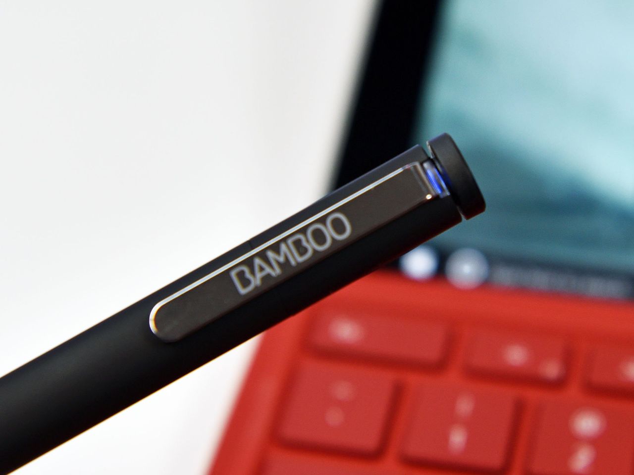

To jump between Wacom AES and Microsoft's Pen Protocol you press the two side buttons simultaneously for two seconds.
A faint blue LED behind the buttons tells you the mode has switched, but it's hard to see.

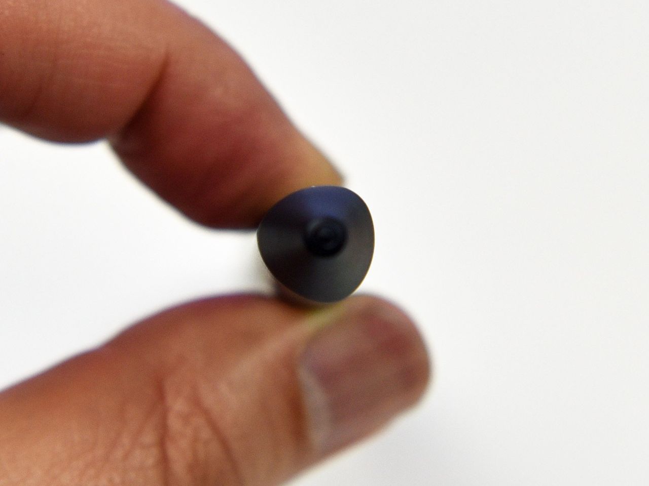

I also prefer the triangular shape of the Bamboo Ink, which is more ergonomic than the Surface Pen. The pen itself is also matte black with a hint of soft-touch paint, and it feels great in hand.
Weight is distributed evenly with the Bamboo Ink. It weighs 19 grams versus the 21 grams of the Surface Pen. Both pens take a single AAAA battery to power the Bluetooth component.
