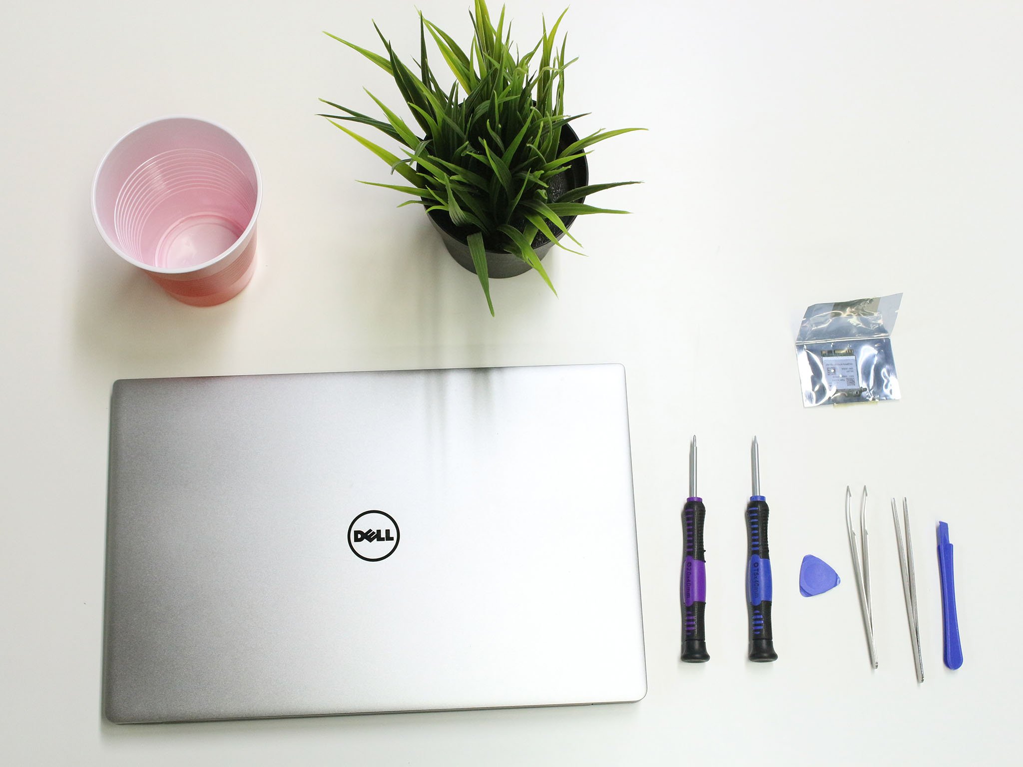

Tools you will need to replace the wireless card in a Dell XPS 13 9350
The tools needed to replace the wireless card in your XPS 13 9350 are:
- T5 Torx screwdriver.
- Phillips No. 2 screwdriver.
- tweezers.
- plastic opening tool (called a scribe).
- a receptacle for the small parts and screws.
If you don't have these tools already lying around the home or office, you can pick up a kit with everything you need and more. Delcast has a great 23-piece set that starts around $27.
