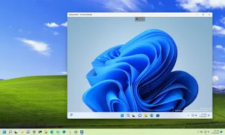

How to get started using Remote Desktop on Windows 11
Windows 11 remote desktop
Windows 11 remote desktop (Image credit: Future)
On Windows 11, you can use the "Remote Desktop" app to control other devices in the Local Area Network (LAN) or through the internet. However, depending on where the device is sitting, the app is only part of the puzzle, as you'll have to configure other settings to make the connection happen.
For example, you'll need to enable the Remote Desktop Protocol (RDP) on the remote computer to allow connections (only available on Windows 11 Pro). If you plan to connect over the internet, you must configure port forwarding on the router. Also, you may have to install the Remote Desktop app and configure a remote connection on the source computer to establish a remote session.
While the Remote Desktop Protocol is only available on Windows 11 Pro, you can install the Remote Desktop app to establish a connection on the Pro or Home editions of Windows, including Windows 10.
This how-to guide walks you through the steps to set up and connect to another computer using the Remote Desktop app on Windows 11.
