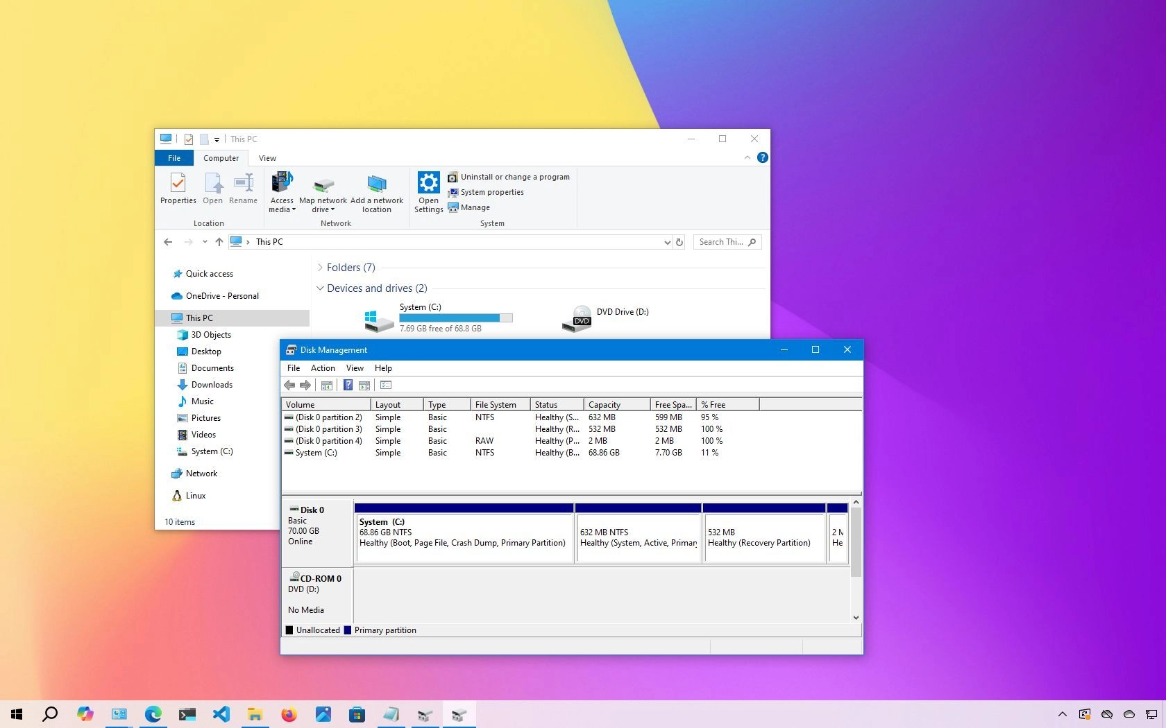

How to fix missing hard drive in File Explorer using Disk Management
There are a few requirements for a hard drive to be available in File Explorer. The device must be online and initialized. It needs to have a partition properly configured. It also needs to have a drive letter assigned, or it should be mounted as a folder.
If you are dealing with any of these problems, the steps below will help you troubleshoot and fix the most common issues with Disk Management.
