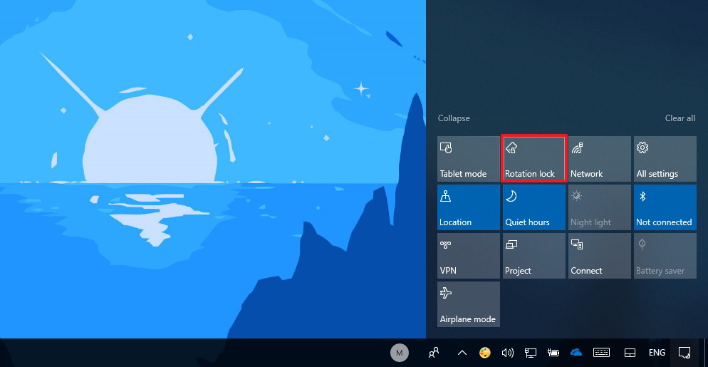

It's also likely that you might have accidentally turned on the rotation lock option that prevents your device from rotating. If this is the case, do the following:
- Use the Windows key + A keyboard shortcut to open Action Center.
- Click the Expand button.
- Click the Rotation lock to turn it off.
- Quick Tip: You can also control this option under Scale and layout on Settings > System > Display.
- Change the orientation of the device to see if it rotates automatically.
