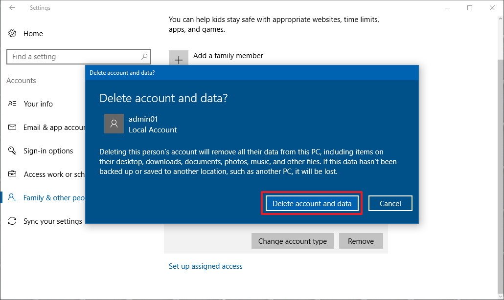

And you should also delete the temporary local user account you created.
- Open Settings.
- Click on Accounts.
- Click on Family & other people.
- Click on the temporary account you've created previously.
- Click the Remove button.
- Click the Delete account and data button to complete the task.
