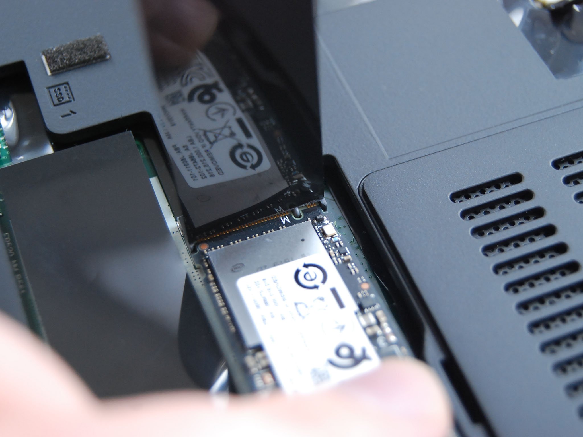

Once you've backed up your data and decided which route you'll take with any necessary cloning, clear out a well-lit workspace and power off your ThinkPad P52 before proceeding with the steps below. In this case, we'll show you the full process of how to remove an M.2 SSD and replace it with a new one. If you're simply adding an M.2 SSD to an empty slot, skip step 5.
- Unscrew the six fasteners on the quick-access panel using a Philips-head screwdriver. The screws can't be removed completely to ensure none are lost.
- Lift up the access panel with a thumb or pry tool. Notice there's a notch along the edge to easily get it up.
- Pull up the plastic shielding over the M.2 SSD slot. Do not remove it completely.
- Unscrew the single fastener at the end of the M.2 SSD. The old SSD should pop up and sit at an angle.
- Slide the old M.2 SSD away from its slot. It should come away with relative ease.
- Insert the new M.2 SSD at a slight angle into the slot. Notice that it is keyed and will only fit one way.
- Screw in the single fastener at the end of the M.2 SSD. Be sure you don't overtighten.
- Replace the plastic shielding over the M.2 SSD.
- Replace the access panel, lining up the fasteners with the silver holes.
- Screw in the six fasteners attached to the access panel.
You can now boot up your ThinkPad P52 to check if the storage upgrade went according to plan. If your system doesn't automatically recognize the new SSD, check out our guide on how to format a new drive to get it working properly. If you want to clone existing data from either the HDD or a secondary M.2 SSD without an external enclosure, you should now be free to do so.
