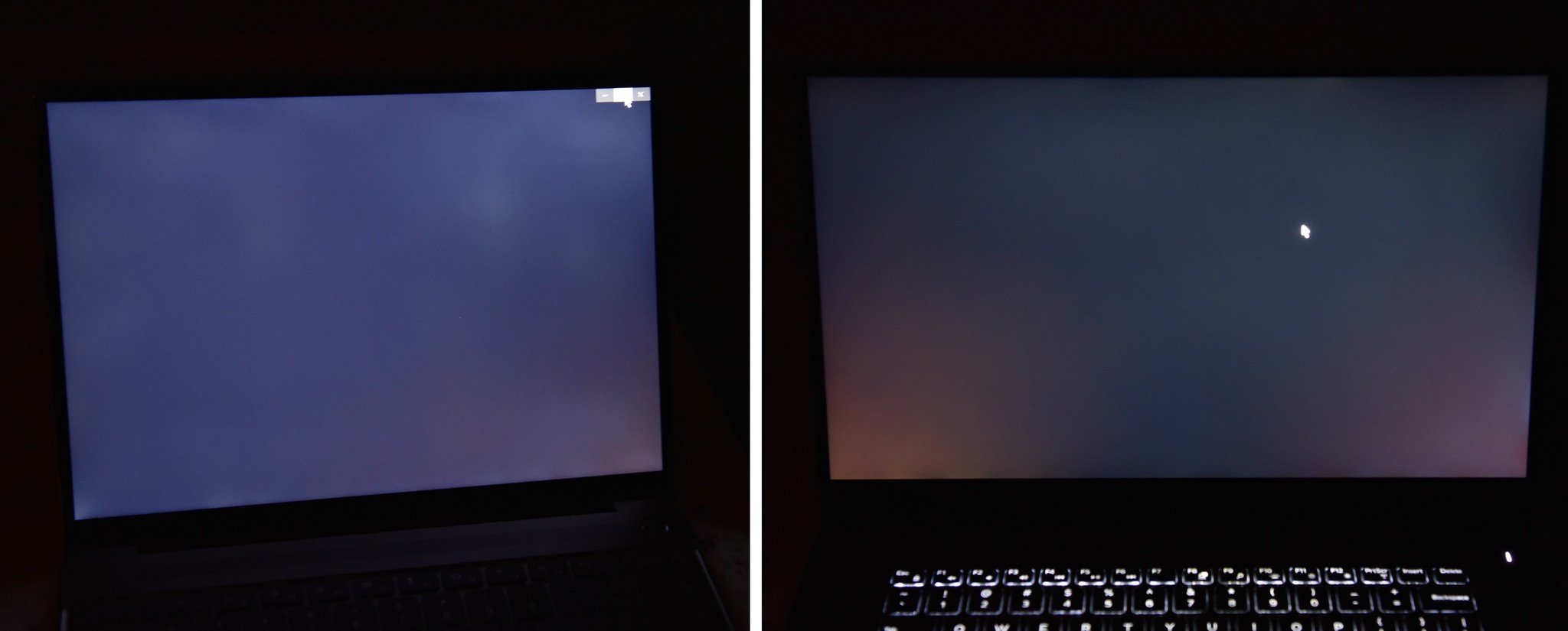

Light bleed is everywhere: Huawei MateBook X (left) vs. Dell XPS 15 with full HD (right).
Above is the brand new Huawei MateBook X with a 2K non-touch IPS display. Next to is the Dell XPS 15 (9560) with a Full HD IGZO non-touch screen. Just awful, right?
HP is not immune to it either. The EliteBook x360 G2 with a full HD display and the Spectre x360 15" with a 4K non-PenTile screen both show various discoloration, hot spots, or "mura." (a.k.a. clouding).
EliteBook x360 (left) vs. Spectre x360 15 with a 4K display (right) all show random bleeds or hot spots.
The point here is that your eye does not actually see this in real life. Light bleed can be severe enough that you see it without the assistance of low-light photography, but do not confuse one with the other. Just because you see photos on the internet does not mean that the actual user experience is hindered.
