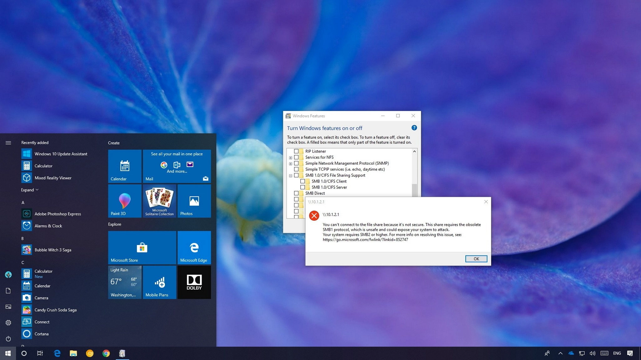

Although there have been three major releases of the protocol, there is a chance that you may still have devices running the original version, such as SMB version 1 (v1) which is old and insecure, and Windows 10 no longer installs it by default starting with the Fall Creators Update and April 2018 Update. As a result, you'll get error messages like "You can't connect to the file share because it's not secure;" "The specified network name is no longer available;" and "Unspecified error 0x80004005" when trying to access your files.

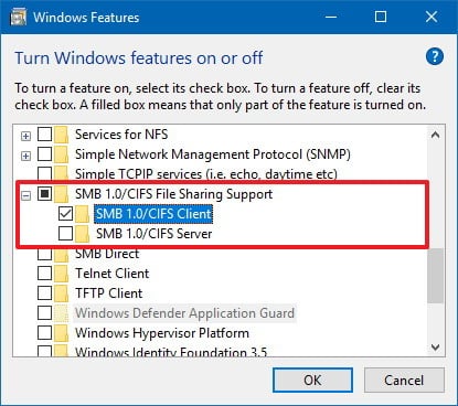

- Open Control Panel.
- Click on Programs.
- Click on Turn Windows features on or off link.
- Expand the SMB 1.0/CIFS File Sharing Support option.
- Check the SMB 1.0/CIFS Client option.
- Click the OK button.
- Click the Restart now button.
After completing these steps, you'll once again be able to see and connect to network devices running the old protocol on your local network from your Windows 10 computer.
