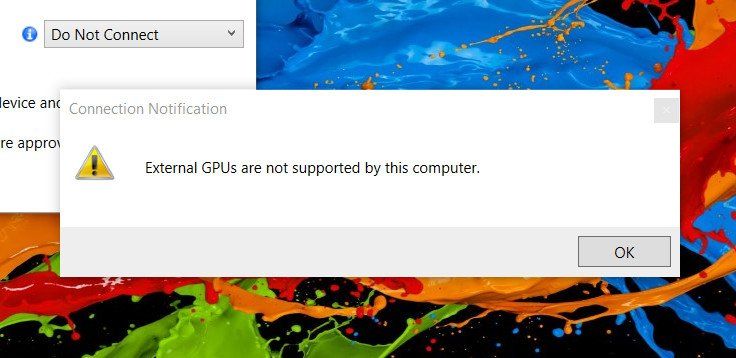

Once you have an external monitor and a Razer Core eGPU wired up with the XPS 15 on AC power, just connect the USB Type-C cable between the Razer Core and XPS 15.

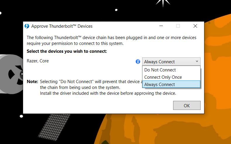

A pop-up notification will warn you that external GPUs are not supported. Hit OK. Next, approve the Thunderbolt 3 device (Razer Core) by choosing Always Connect from the pop-up notification.
