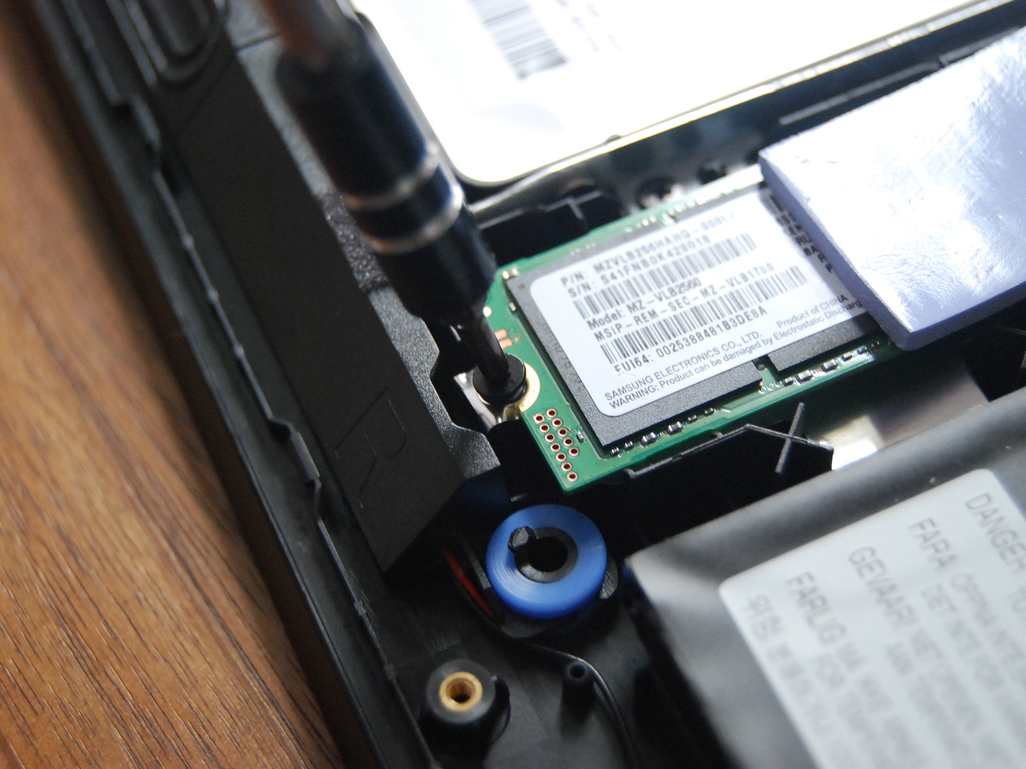

- Unscrew the single black fastener holding the M.2 SSD in place using a Philips-head screwdriver.
- Pull the old M.2 SSD away from the mount. It should slide out easily.
- Insert the new M.2 SSD into the slot. It is keyed and should only fit in one way.
- Screw in the single black fastener at the end of the M.2 SSD, being careful not to overtighten.
- Replace the sticky silicone pad on top of the SSD. This helps dissipate heat produced by the SSD.
