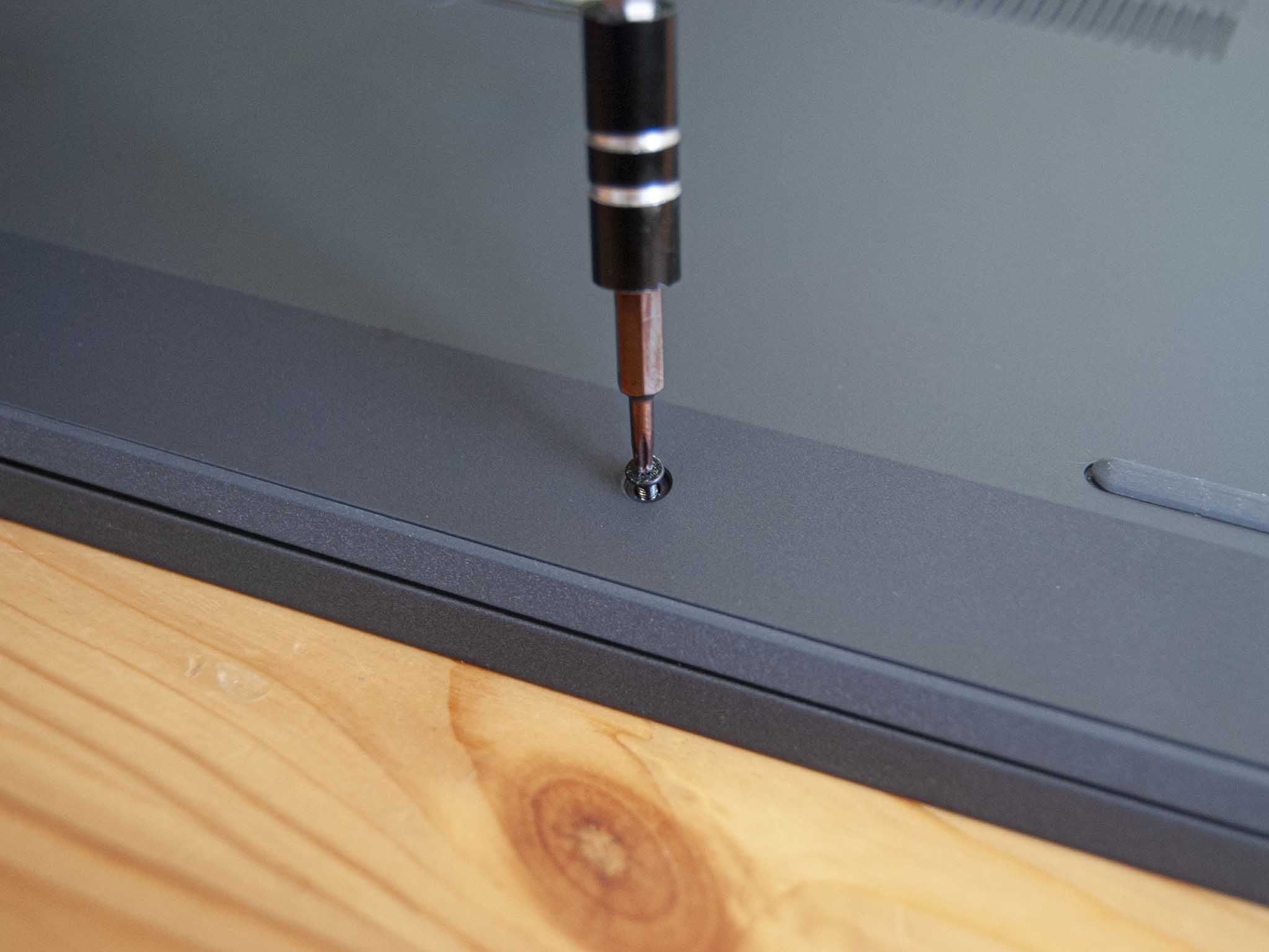

  1. Unscrew the nine fasteners on the back of the Flex 5 14 using a Torx 6 bit. Note that the four shorter screws go along the front edge that is tapered, while the five long screws go in the rear raised portion.
