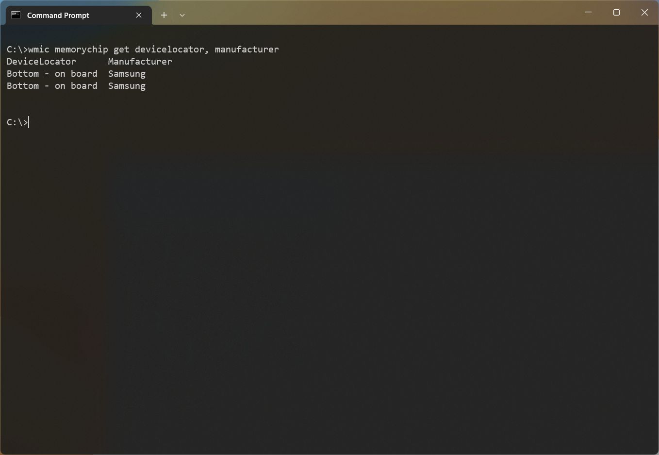

Check manufacturer
To find out the memory manufacturer, use these steps:
  1. Open Start.
  2. Search for Command Prompt, right-click the top result, and select the Run as administrator option.
  3. Type the following command to determine the memory manufacturer name and press Enter: wmic memorychip get devicelocator, manufacturer
(Image credit: Future)
  1. Confirm the memory manufacturer name under the "Manufacturer" column.

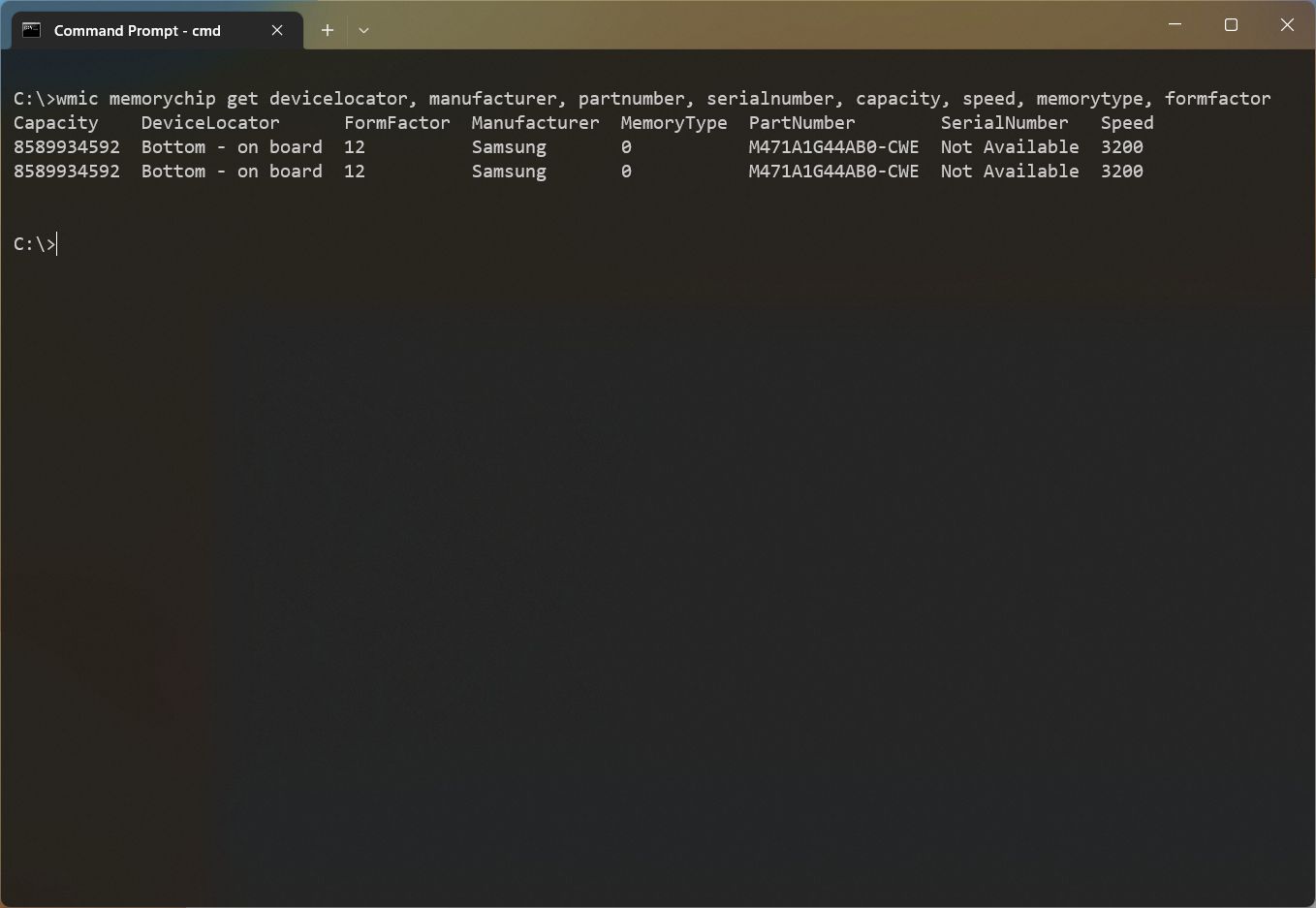

Check full specs
You can use the previous command to find specific information about the memory modules individually. However, you can also query all the memory specs with a single command on Windows 11.
To view all the memory details, then use these steps:
  1. Open Start.
  2. Type Command Prompt, right-click the top result, and select the Run as administrator option.
  3. Type the following command to view all the memory details and press Enter: wmic memorychip list full
  1. Confirm the specs for each module installed on the device.
  2. (Optional) Type the following command to view only the specific details and press Enter: wmic memorychip get devicelocator, manufacturer, partnumber, serialnumber, capacity, speed, memorytype, formfactor
  1. Confirm the memory details.
Once you complete the steps, you will have a full overview of the memory specifications.
