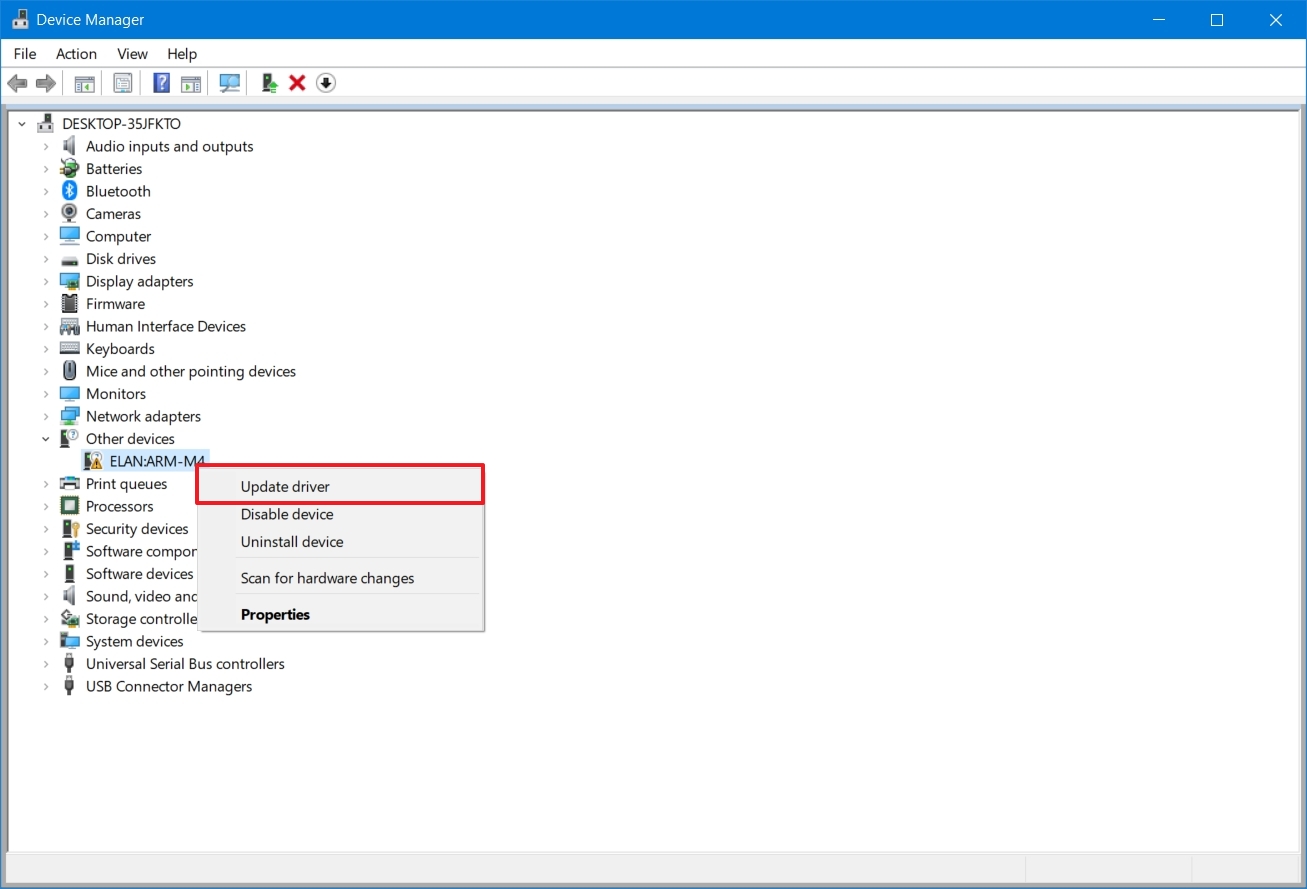

  1. Open Start.
  2. Search for Device Manager and click the top result to open the console.
  3. Right-click the device with the yellow exclamation mark and select the Update driver option.
(Image credit: Future)
  1. Click the "Browse my computer for drivers" option.
  1. Click the Browse button.
  1. Select the extracted folder containing the driver update.
  2. Check the Include subfolders option.
  3. Click the Next button.
  4. Click the Close button.
After you complete the steps, the driver will install, and the exclamation mark should disappear from Device Manager.
