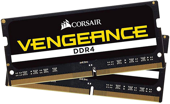

- DDR4-2933MHz RAM: Corsair Vengeance 32GB

Something like Corsair's Vengeance DDR4-2933MHz RAM is going to offer an excellent price-to-performance ratio for your GE66 Raider. Two 16GB sticks for a total of 32GB is about $125, which is in most cases a lot less expensive than configuring a model from the factory.

Corsair's Vengeance SODIMM DDR4 RAM is reliable and affordable. If 32GB isn't what you need, you can always pick up different sizes to suit your needs. MSI's GE66 Raider is a high-end 15.6-inch gaming laptop available with some truly impressive hardware options.
