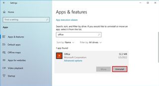

Uninstall incompatible app
To uninstall an app that may conflict with the Windows 10 installation, use these steps:
  1. Open Settings.
  2. Click on Apps.
  3. Click on Apps & features.
  4. Select the app that is causing issues and click the Uninstall button.
(Image credit: Mauro Huculak)
  1. Click the Uninstall button again.
  • Quick note: If this is a classic desktop application, you may need to continue with the on-screen directions to complete the uninstall process.
Once you complete the steps, you may need to repeat the instructions to uninstall additional apps, and then you can try the upgrade one more time. After the update, you can reinstall the apps again.

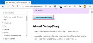

Alternatively, you can also troubleshoot blue screen errors with the "SetupDiag" tool. It's a Microsoft tool that offers an optional download to diagnose and determine why an update or upgrade failed to apply, which is valuable data that can help resolve virtually any problem.
To use SetupDiag after the upgrade of Windows 10 failed with a blue screen, use these steps:
  1. Open the SetupDiag download page.
  2. Click the Download SetupDiag button.
  1. Select a destination folder to save the file.
  2. Click the Save button.

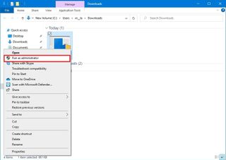

  3. Open File Explorer.
  4. Open the folder where you downloaded the file.
  5. Right-click the "SetupDiag.exe" and select the Run as administrator option.
(Image credit: Future)
  1. Right-click the SetupDiagResults.log file and select the Open option.
Once you complete the steps, the default text editor will open the file with the diagnostic results based on the known rules.
If an error was detected, the logs will describe the information to determine why the device blue screened during the update, and if it's a known issue, you'll also get the steps to resolve it.
Sometimes you won't get any recommendations. If this happens, follow the link that might be available in the log file or use the error code or any meaningful information to research the problem online. (Use this guide for more detailed instructions.)

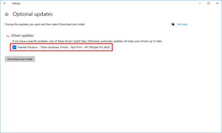

Windows can also crash due to a hardware-related problem. As a result, it's always recommended to disconnect peripherals that are not essential to interact with the computer, including external hard drives, printers, secondary monitors, phones, and other USB or Bluetooth devices, before proceeding with an installation to minimize the chances of errors. The upgrade process only requires a keyboard, mouse, monitor, and internet connection.
After the installation, you can reconnect the peripherals. If the issue persists, it could be a compatibility problem. You can usually resolve this issue by downloading and installing a newer driver version from your manufacturer's support website.
If the computer uses the most recent driver and the problem continues, it could be a compatibility issue with the new version of Windows 10, or the hardware in question may need to be replaced.

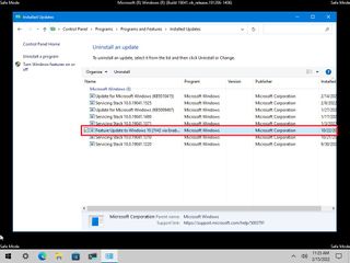

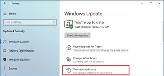

To uninstall a problematic update on Windows 10, use these steps:
  1. Open Settings.
  2. Click on Update & Security.
  3. Click the "View update history" option.

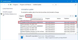

  1. Click the Uninstall updates option.
  • Quick note: If the Windows Update settings doesn't show option to remove an update, then open Control Panel > Programs and Features > View installed updates, and continue with the steps below.
  1. Select the most recent update (refer to the "Installed On" column).
  2. Click the Uninstall button.
After you complete the steps, restart the device and confirm that the error is no longer happening.

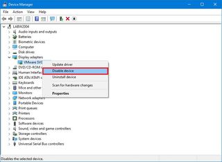

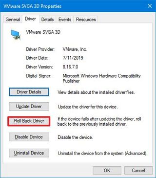

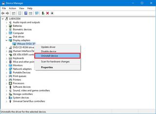

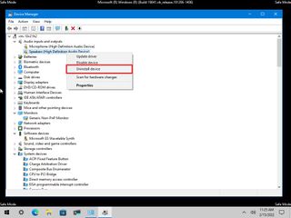

Remove buggy device drivers
To uninstall an incompatible driver with Safe mode, use these steps:
  1. Open Start.
  2. Search for Device Manager and select the top result to open the app.
  3. Expand the branch with the device causing the problem.
  4. Right-click the device and choose the Uninstall device option.
  1. Click the OK button.
Once you complete the steps, restart the computer and determine whether the bug check has been resolved.

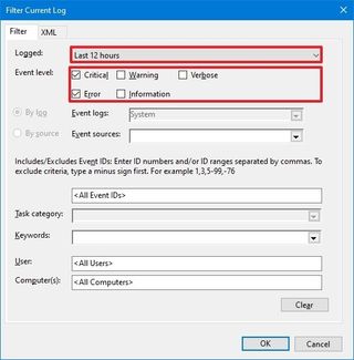

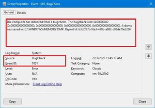

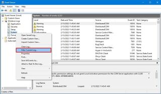

Troubleshoot bug check with Event Viewer
If you cannot find the error code during the blue screen or want more details about the problem, the Event Viewer records every hardware failure, driver malfunction, app crash, and more information, which you can use to diagnose most problems.
To troubleshoot blue screens with the Event Viewer on Windows 10, use these steps:
  1. Open Start.
  2. Search for Event Viewer and click the top result to open the app.
  3. Expand the Windows Logs group.
  4. Select the System category.
  5. Right-click the "System" category and choose the "Filter Current Log" option.

  2. Double-click to open each log to learn more details about the problem.
  1. Review event log details.
  • Quick tip: When a blue screen occurs, the system creates a memory dump file and restarts the device automatically. This means that if you have a list with many errors because the computer rebooted immediately after the bug check, the error causing the problem is likely to be one after a critical Kernel-Power event.
In the event log, the "General" tab includes a brief technical description of the error that might give you a hint of the blue screen problem.
In this guide, I forced a bug check using these instructions, so the event notes that the source of the problem was a "bug check" that caused the computer to reboot unexpectedly. However, it's not always easy to determine the source of the issue. If you can't find out the reason based on the event information, copy the description, source, and event ID and use it to research online for a possible solution.

Uninstall quality or feature updates
To uninstall the most recent quality or feature update causing the Blue Screen of Death, use these steps:
  1. Click the Advanced Startup option.
  • Quick note: If accessing Advanced Startup from USB media, you will have the Troubleshoot option instead (see step 2).
  1. Click the Troubleshoot option.
  1. Click on Advanced options. (This step is not part of the process when using USB media.)
  1. Click the Uninstall Updates option.
  1. Click the "Uninstall latest quality update" to remove a recent monthly update. Or click the "Uninstall latest feature update" option to roll back to a previous version.
  • Quick tip: If you select the "Uninstall latest feature update" option, you can continue with the same steps to remove the recent upgrade of Windows 10 (as long as it's been less than 10 days since the installation).

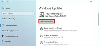

System update
Windows 10 downloads and installs updates periodically, but you may still need to check manually to download a critical update.
To download and install updates on Windows 10, use these steps:
  1. Open Settings.
  3. Click on Windows Update.
  4. Click the "Check for updates" button.
If an update is available but does not download, try downloading and installing the missing quality update manually.

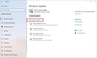

Driver update
When the problem is an outdated driver, you'll need to download and install the latest version.
To install a newer version of a driver, use these steps:
  1. Open Settings.
  4. Click the Check for updates button (if applicable).
  5. Click the "View optional updates" option.
  • Quick tip: If the option isn't available, it means that Windows Update doesn't have any updates for your system configuration.
  1. Click the Driver updates tab.
  2. Select the driver update.
  1. Click the "Download and install" button.
Once you complete the steps, the latest version of the driver should solve the problem. If no updates were available, you might need to check the manufacturer's support website to download and install a newer driver using their instructions. If the support website doesn't have a version higher than the one you already have, you may also want to try a beta version of the driver, as it may contain a preview of the fix the company may plan to release on a future release.

Uninstall system updates
To uninstall a buggy system update, use these steps to remove it:
  1. Open Settings.
  1. Click the Uninstall button.
After you complete the steps, the problematic update will be uninstalled, fixing the Blue Screen of Death error. You can also use these steps to prevent the Windows Update settings from trying to install the same update again.
Uninstall device driver
To uninstall a buggy driver, use these steps:
  1. Open Start.
  2. Search for Device Manager and click the top result to open the app.
  3. Right-click the device and select the Uninstall device option.
Once you complete the steps, you should no longer see the bug check error on the computer.

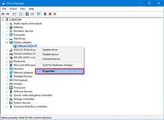

Roll back device driver
It's also possible to roll back the previous version of the driver to resolve the issue until another update replaces the buggy update.
To roll back to a previous version of the driver on Windows 10, use these steps:
  1. Open Start.
  2. Search for Device Manager and click the top result to open the console.
  3. Expand the category of the device with the problem.
  4. Right-click the device and select the Properties option.
  1. Click the Driver tab.
  2. Click the "Roll Back Driver" button (if available).
  • Quick tip: If the option isn't available, the system doesn't have a backup of the previous driver.
  1. Select one of the available options to answer the question.
  2. Click the Yes button.
After you complete the steps, the older version of the driver will apply to the system, fixing the system crashes.
Disable device driver
If you cannot roll back the driver, another workaround you can use involves disabling the hardware to mitigate the blue screen error until a new update becomes available to fix the issue permanently.
To disable specific hardware on Windows 10, use these steps:
  1. Open Start.
  4. Right-click the device and select the Disable device option.
  1. Click the Yes button.
Once you complete the steps, you should no longer experience system crashes.
Uninstall conflicting apps
If you have an app causing compatibility problems, the Blue Screen of Death is likely to happen randomly or every time you launch the program.
You can circumvent this problem by downloading and installing the latest version of the app from the software support website. If an update isn't available, it's recommended that you uninstall that program to mitigate the problem until a permanent solution becomes available.
To uninstall a problematic app on Windows 10, use these steps:
  1. Open Settings.
  2. Click on Apps.
  4. Select the app causing the Blue Screen of Death and click the Uninstall button.
  2. Continue with the on-screen directions (if applicable).
Once you complete the steps, you should no longer experience blue screen error codes on the device.

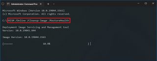

Run DISM and SFC tools
When dealing with a blue screen error, you can also use the System File Checker (SFC) combined with the Deployment Servicing and Management (DISM) tool to repair damaged system files to resolve the problem.
Repair image files with DISM
To repair the locally available image with DISM, use these steps:
  1. Open Start.
  2. Search for Command Prompt, right-click the top result, and select the Run as administrator option.
  3. Type the following command to repair the Windows 10 image and press Enter: DISM /Online /Cleanup-Image /RestoreHealth
Once you complete the steps, the tool will download and replace any system file that may be damaged in the local image of Windows 10.
If you still can log in to your account, you can also use the Event Viewer to determine the reason for the problem to find a proper solution.
To check the event logs for hints about the Blue Screen of Death messages, use these steps:
  1. Open Start.
  4. Right-click the "System" category and choose the "Filter Current Log" option.
  1. Click the Filter tab.
  2. Use the Logged drop-down menu and select the time range when BSoD happened — for example, Last 12 hours.
  3. Check the Critical and Error options under the "Event level" section.
In the event log, the "General" tab includes a brief technical description of the error, which might give you a hint of the bug check problem. If you can't determine the reason based on that information, copy the description, source, and event ID and use them to search online for a possible solution.
