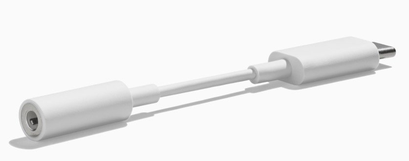

There are two ways to send audio data through the USB port, and I'll bet you can guess them: Analog and digital. Analog audio can be converted with an onboard DAC and amplifier inside your phone then sent out through the port to a passive set of headphones or an adapter. For this to work, the device needs to support whats called "audio accessory mode" and the headphones or adapter are just "dumb" connections that pass along the signal.
If you are using an active set of headphones or adapter, the audio signal being sent through the USB port is still in its digital form. That means the DAC and amplifier are inside of the headphones or the dongle, and the conversion is done there instead of the phone.
Buying USB-C headphones can be torturous; get advice from someone who has been there.
This can get messy. You need to make sure that you're using the right "thing". If you are using a passive adapter or headphones, your phone needs to support audio accessory mode and many don't. The mess is because most dongles, adapters, and headphones aren't labeled with how they are built and we don't know if they are active or passive.
The Pixel 2 has an onboard DAC embedded in its Qualcomm Snapdragon 835 SoC, but audio accessory mode isn't supported. That means you need a pair of active headphones or an active adapter, like the dongle that came with the phone. The HTC U11 and Essential Phone are the same, and the only phone I've heard (but am unable to test) that does support USB audio accessory mode was the LeEco Le Pro3. All phones should support an active adapter or headphones, though.
